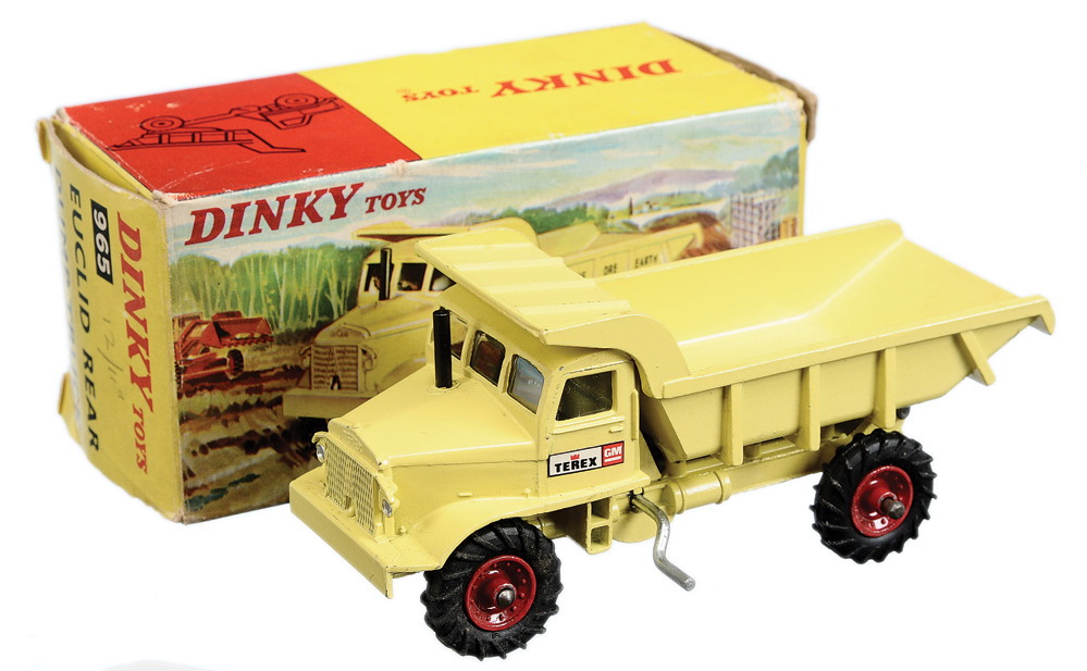

The earliest following coloured Supertoys lid box with the hoist scene I found, according pencil price of 11/6 on the box, dating on January 1964. These red/yellow coloured lid boxes no longer contains a printed quality control stamp in the lid of the box, but a separate small white label with a control stamp without date. Usually these labels get lost over time, but it was still in my box.
The box after that is a yellow/red coloured end flap Dinky Toys box with a dig scene on the front side. The earliest date I could find, according to a pencil price of 12/11, is January 1967-1968.
The last issued box is the only original Dinky Toys Terex picture box with the real Terex Truck picture on the front side and issued, according to the pencil price 14/11, in 1969 - 1970.

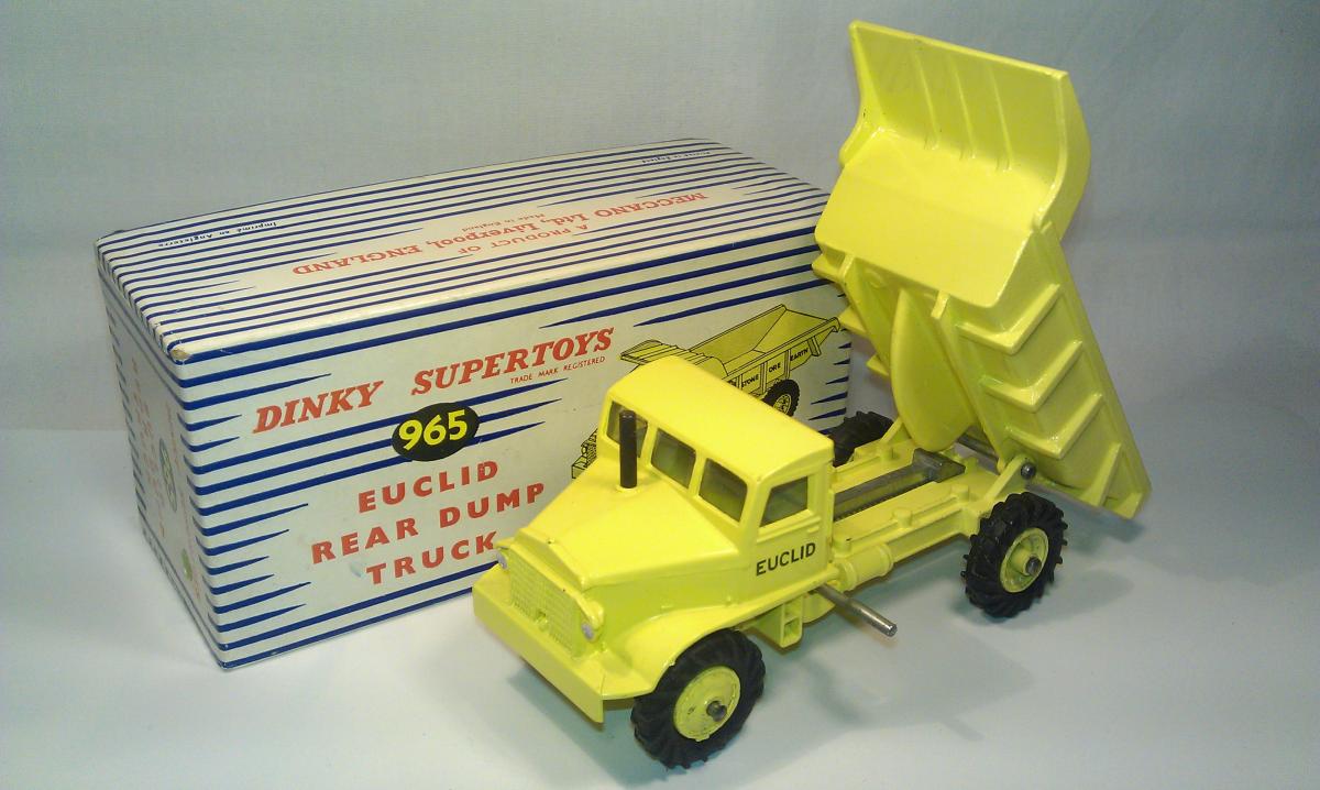

Hi Jan, another example of asynchronous features which happened so often in the factory. In fact it is obvious that the dates as registrated in the changes list on the factory drawings seem rarely synchronous with what really happened in the factory. Even the separately produced parts, like the cabin/chassis unit and the tipping body may have been made on quite different moments and under different circumstances. One of my examples shows a tipping body colour which has a shade different from the rest of the model. I will not show a photograph of that because it's extremely difficult to represent that difference photographically in a natural way.
Nevertheless, busy compiling my private Dinky calendar for next year at this moment, I came across the photo below, presenting a display view of my modest 965 collection. I like it and included it immediately. Kind regards, Jan W
