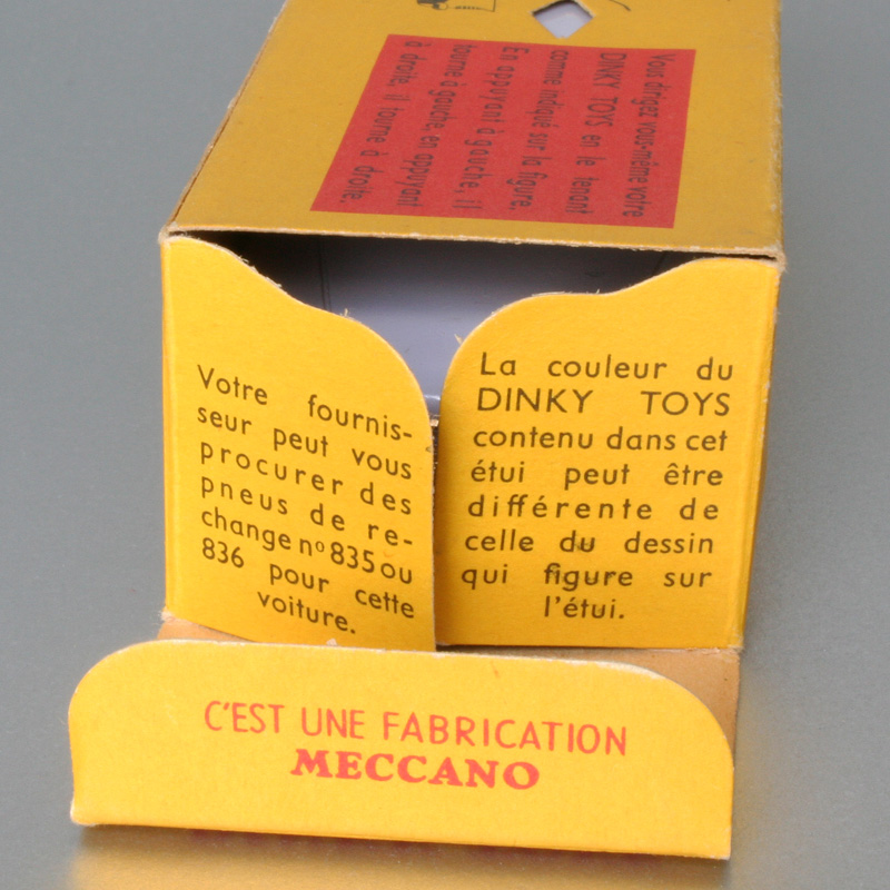

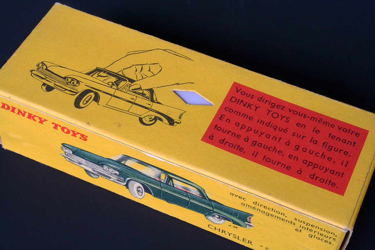

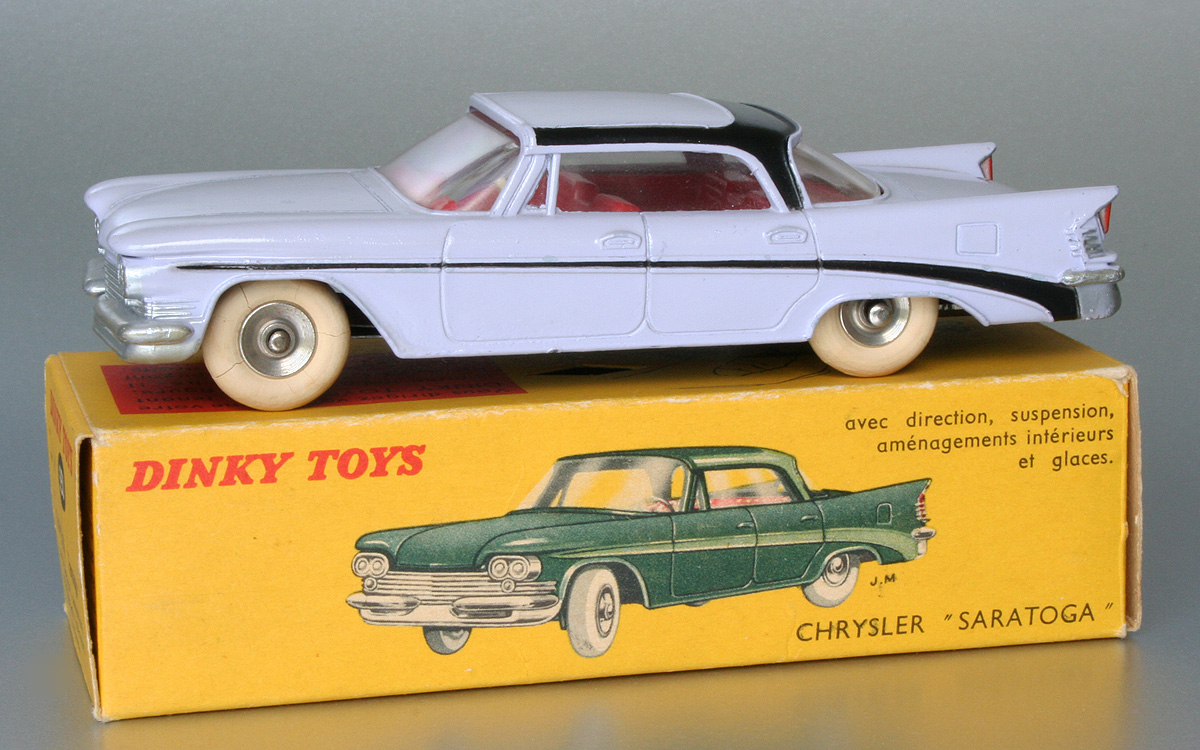

Regarding the colour lozenge in the Desoto Diplomat's box of Terry's I can show some photos of the Chrysler Saratoga, a childhood French Dinky of mine. The open lozenge has the advantage that there is never a mismatch of the colour dot on the box and its contents. Although this is very efficient and  obvious, in their catalogues and on the boxes themselves the French often showed even non-existing colours of the model, as this Chrysler's box (like the Desoto Diplomat's and many others') demonstrates. The warning for this difference, at the moment that you have almost opened the box already, is slightly late! Kind regards, Jan

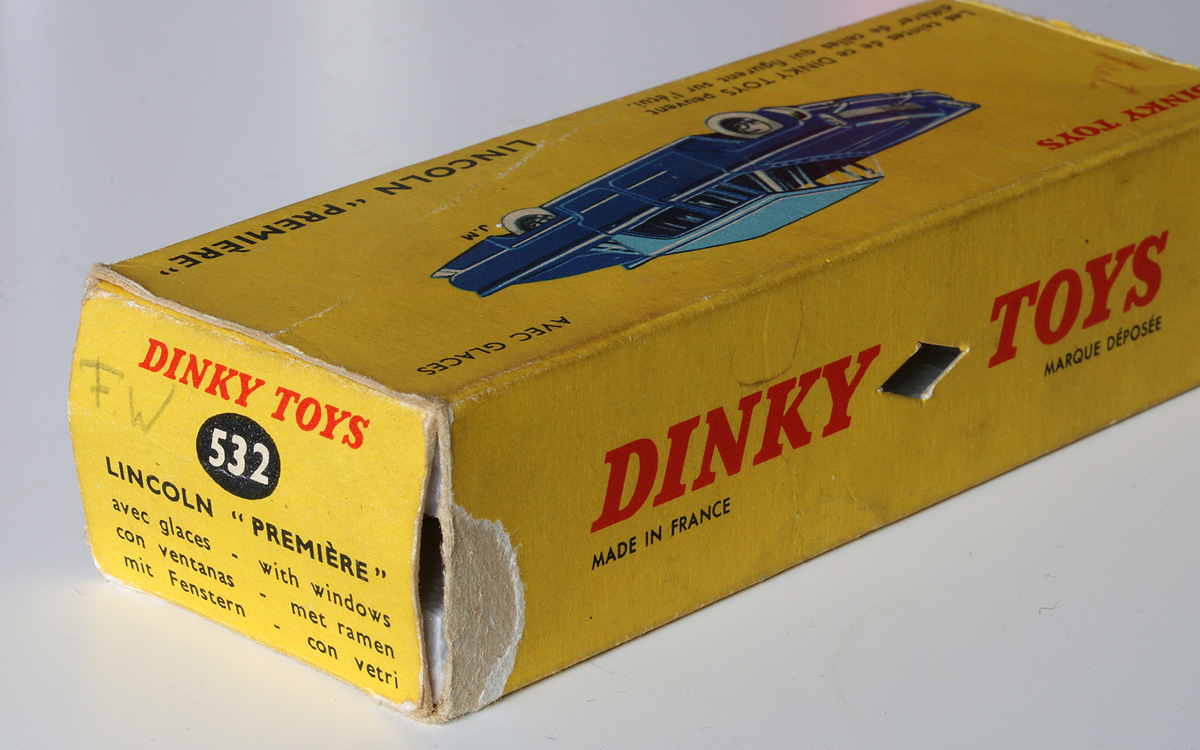

I have the diamond cut-out on my two 532 Lincoln Première and these are on one of the side panels. Although I have photographed both models, I never thought of photographing the diamond cut-out on the box’s side.

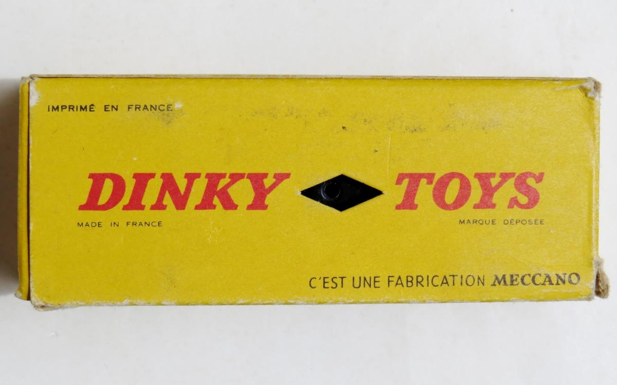

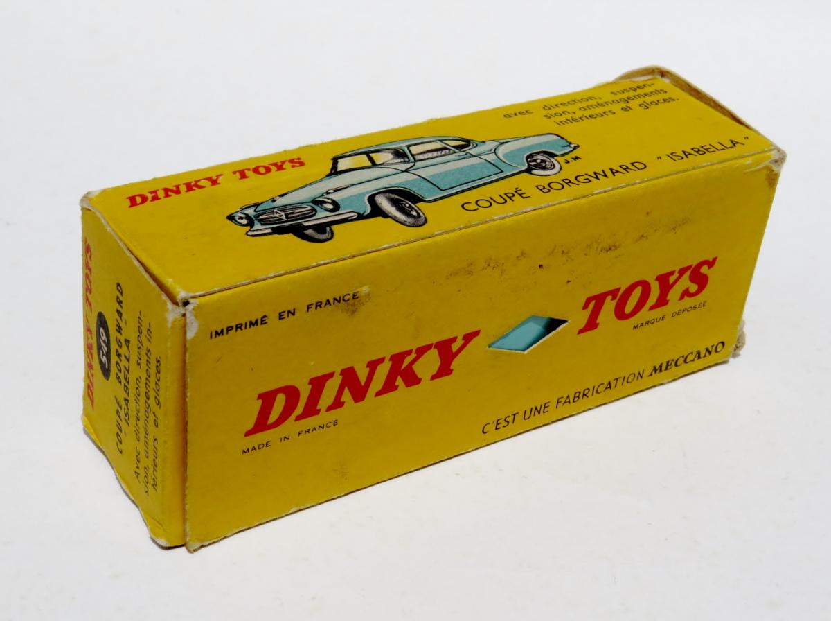

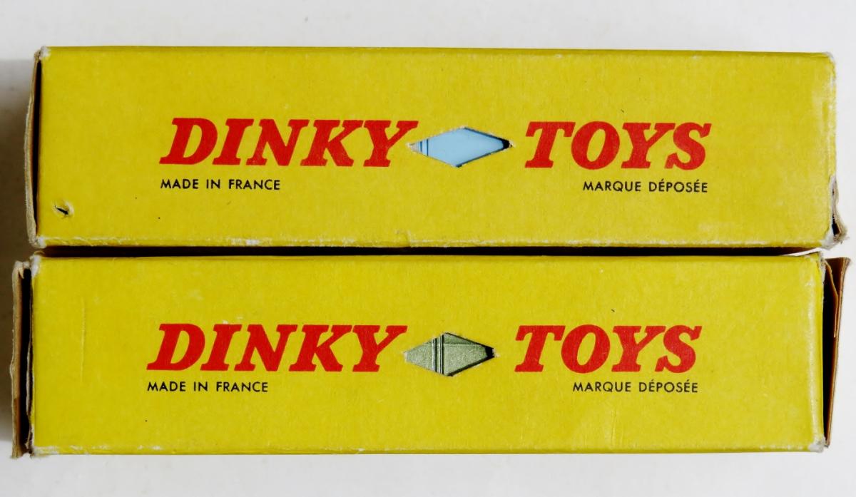

Hello Jan
As shown in the first image below, these are my two 532 Lincoln Premiére, showing the difference when models are inserted into their box either front or rearwards. (Depending on which end flaps are opened!)
Image 2 is the 549 Coupé Borgward  “Isabella” which shows the difference in placement of the picture of the car which is now on the side panels, thus necessitating the diamond cut-out being on the upper panel of the box.  With the upper panel having a description of the directional steering, this leaves only the lower panel available as shown in Image 3.
Image 4  shows what happens when the model is inserted into the box “right way up”, that is, sitting on its wheels. The diamond cut-out only shows the black of the base plate!
Image 5 shows the model’s colour when the model is placed inside its box “upside down”.
Image 6 shows more of the model’s colour when the model is placed inside the box, tail first!
(150)20160307/826/1735

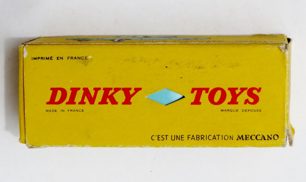

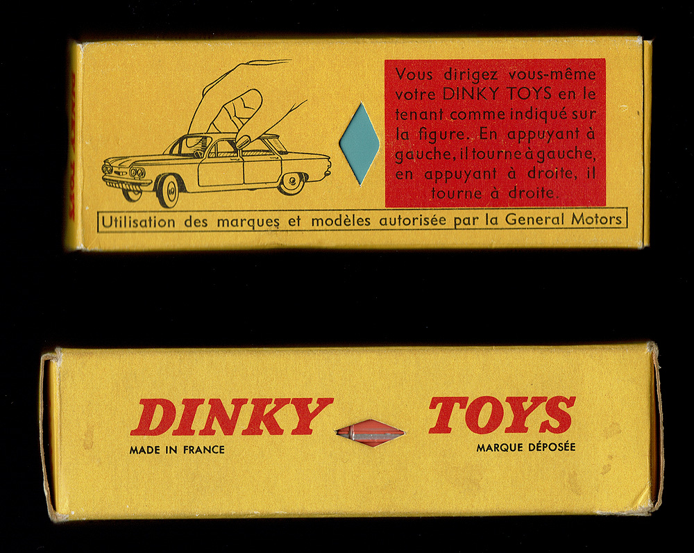

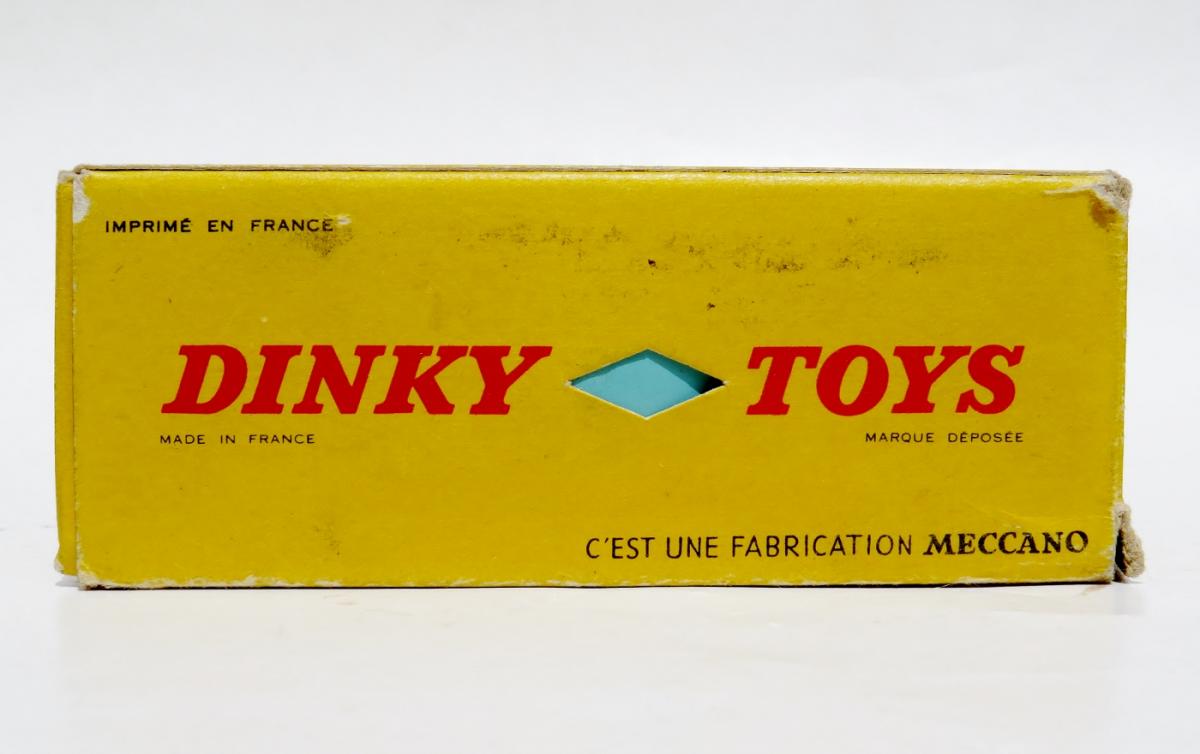

Bruce, as far as I know the French did not use colour spots indeed. So it was clever to use this method of peeping in, no colour spots necessary and no confusion because of possible wrong colour spots. And indeed some contemporaries were lacking both colour spot and peeping lozenges (As I only write and spreak artificial 'vocabulary English' you may encounter such odd use of unfamiliar terms from melaugh. Glad you appreciate it!). My boxes are not all ready accessible but I managed to lay one couple on the scanner: the turquoise 552 Chevrolet Corvair (hole on top, roof view) and the pink orange Desoto Diplomat (hole at the side of the box, showing main colour and silver detailing). Kind regards, Jan

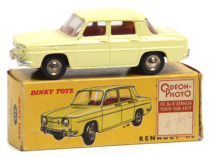

Some Dinky Toys dealers applied their own label on the yellow boxes to show the price of the model or only their name and address. I am looking for some photos of such labels with the name of French dealers.
I will be grateful if any one can provide such pictures.

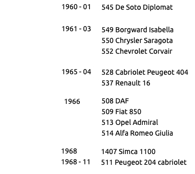

Back to the boxes with peep hole. (kids under 18 may look in).
There were five batches separated by long periods. I think that this may be due to the fact that Meccano had two suppliers for the boxes which is a must in any industry. The boxes with lozenge cuting were plobably made by the second source which was not the main one.
If this list is not complete, please let me know.

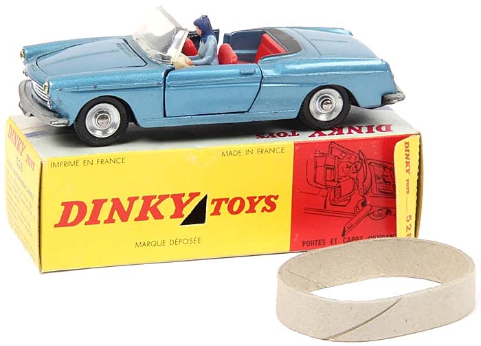

Of course as we are studying Meccano products there is an exception : the Peugeot 404 cabriolet the box of which does not have a diamond cuting but a triangular one. Photo by courtesy of Collectoys.
Many boxes of this period did not require a cut out as they were issued in only one finish.

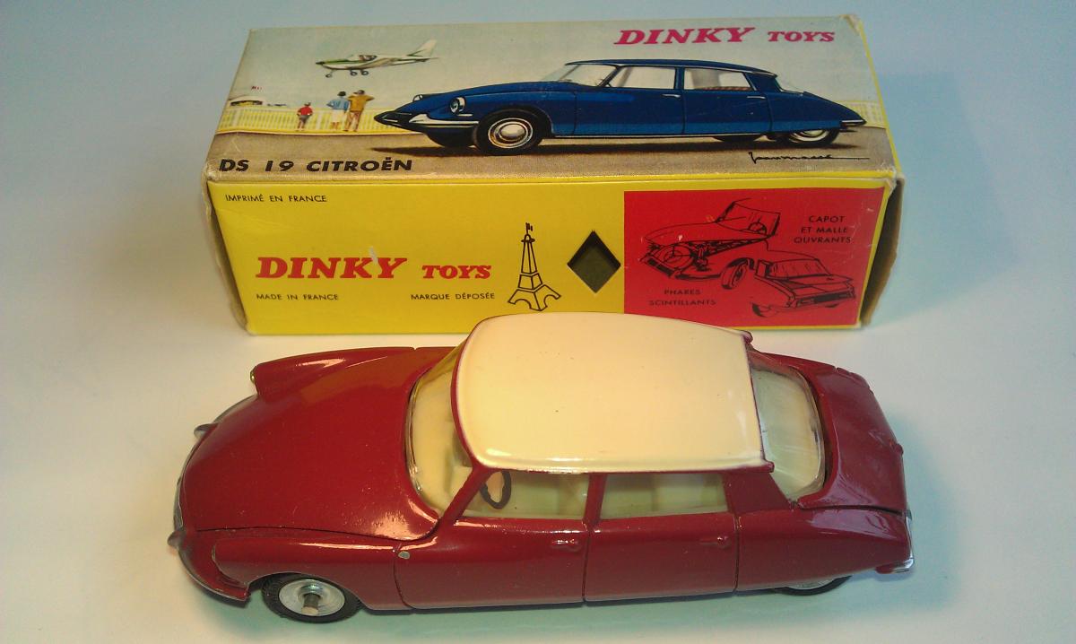

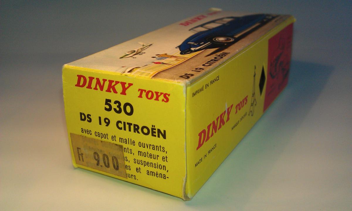

Jacques. Here is my 530 DS 19 Citroen (1964-1970) with open window pane in the box. It has a sticker on the box with the price Fr 9.00, but I don't have a French price list with that price to be able to date the model and box.
Jan Oldenhuis.
Dear Jan
Thank you, I had also missed that one. Who ever sold yours for Fr. 9,00 was not very honest.
