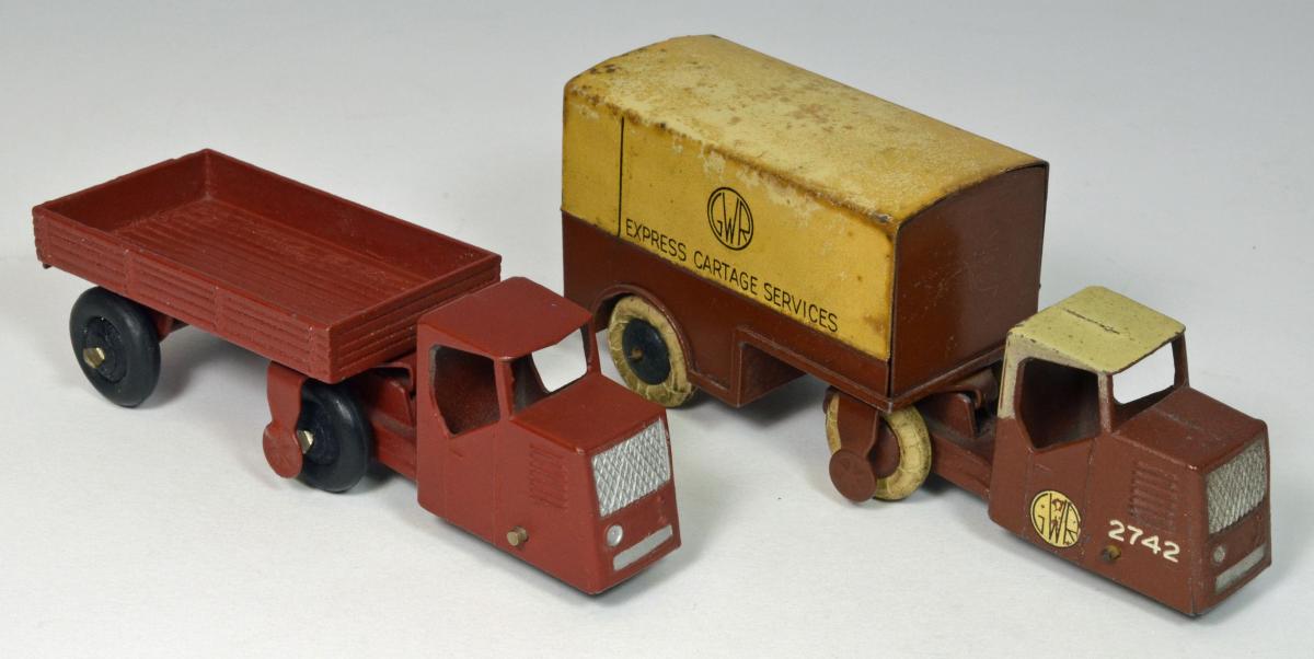

Hi, the no. 33w Mechanical Horse and Open Wagon is a familiar item. Pre-war it could be realized by combining the independent nos. 33a and 33c. Post-war it was available for 10 years (1947-1957), indeed, as no. 33w.
But there is also a Mechanical Horse and Covered Wagon. Many of you may have seen an example every now and then, but not often.
Above two examples, my post-war version on the left and David Cooke's nice pre-war version on the right. Still, it is never mentioned officially as far as I know.
So, my questions are:
a. What catalogue number or other reference can be attached to this model?
b. A regular trade box of the no. 33w Mechanical Horse and Open Wagon will not do for this model (see image above). It will need a higher packing than that. Has anybody ever seen a trade box with/for this covered model?
I look forward to any ideas or comments!
Kind regards, Jan Werner

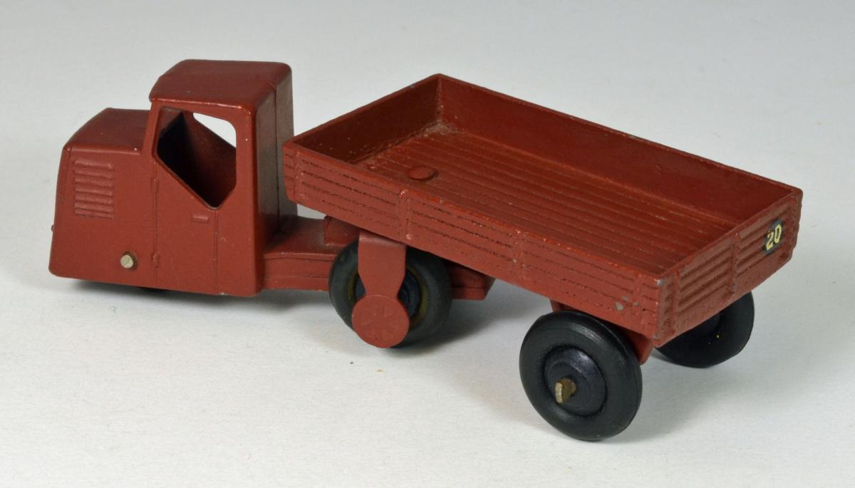

A recent Mechanical Horse and Open Wagon acquisition produces the seventh post-war variant in my collection. An overview:

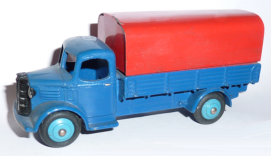

Jan--I remember seeing some of your earlier posts on these, and the covered trailer version in particular. What a splendid collection you have, and in so many nice colors. Her in the states, we tended to see the later blue and cream version most of the time.
I also remember some discussion about that tilt, and was it the same as on the Austin covered wagon? Seems like measurements were made and it was found there were small differences......any recent thoughts on that? I tend to believe that these were produced by Meccano and somehow not listed. Has Jacques weighted in on this before??? It would have certainly made sense to offer these, as the pre-war trailer was not continued, and a proper tilt was that was needed
Hi Terry, unfortunately I still do not have the final answers to some of my questions put above. However, one of your questions, regarding the sharing of the tilt, can be answered visually below:
As far as I know, all covered trailers are code 3 and Meccano never issued this model. There is no document or box to prove that it was ever made. It is too easy to make one.

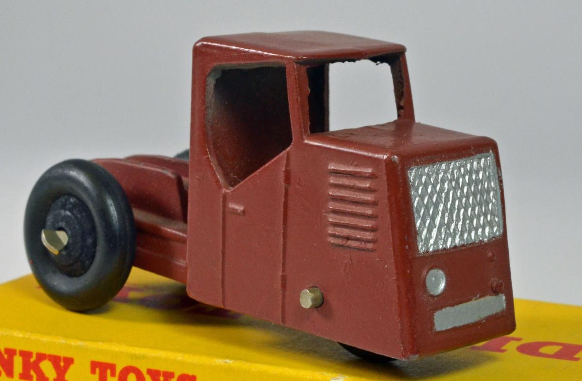

I just received a new Dinky Toys model a couple of days ago, and it is an early 1950's Mechanical Horse and Open Wagon, in the satin brick red color.  When I saw this listed on eBay, it just said used and in good condition.  When I received it, I was pleasantly surprised to see it was almost mint, with hardly a mark anywhere.  Even the coupling latch is almost free of marks or wear spots, so it almost looks like this was stored with the wagon separate from the tug.  As you can see, this one has the black ridged wheels, and the 20 mph roundel on the back, along with crimped axle ends.  So I am guessing around 1952 or so for a production date?  Please weigh in with your thoughts about dating this one.  This is the first Dinky model I have bought with the satin brick red color, so it is new to me.  I guess I am wondering what the origin was of this color, particularly in the satin or flat finish, as almost all Dinky's from that era feature gloss paint.  Was this color type used often in the British motoring industry on commercial trucks?  This color is similar to, but not exactly the same as the pre-war Mechanical Horse and enclosed trailer, in the GWR livery, so I have included a few photos showing the two of them together.  I never thought much of the Mechanical Horse and Wagon as a youngster, but in my later collecting years have come to appreciate what a neat little and unusual model that it is!
                    Regards,  Terry
Hi Terry, a real beauty there! I would narrow the production era of his one to 1947-1949. The black hubs (and these monochrome colours) were discontinued at the end of 1949 as far as I know. I understand that the box on the third illustration just serves as a stage and does not belong to this very model. Kind regards, Jan

John---I compared my post-war Austin Wagon bed with that of the 25 series open wagon.  I did not actually measure them, but I lined them up, side by side, right next to each other.  And I have a very good eye for discerning small differences in dimensions, and I can tell you the beds are the same length and width in the 25 series wagon and the Austin wagon.  Doing the same comparison with the trailer from the Mechanical Horse, it is obvious that that the bed of the Mechanical Horse trailer is slightly shorter.  It also appeared that by trimming or filing the fitting edge of the 25/Austin tilt, by a very small amount (1/32" or so), it would fit nicely, and that could be done in a matter of a few minutes with a good file.  With no evidence to suggest otherwise, I think we are left stating that the Mechanical Horse always came with an open wagon, and that many were adapted to covered via a slight modification that anyone could do.  I do think that Dinky maybe missed the boat by not offering it with a tilt, and then using various liveries.....it would have been a natural thing to do.
                  Best regards,  Terry
