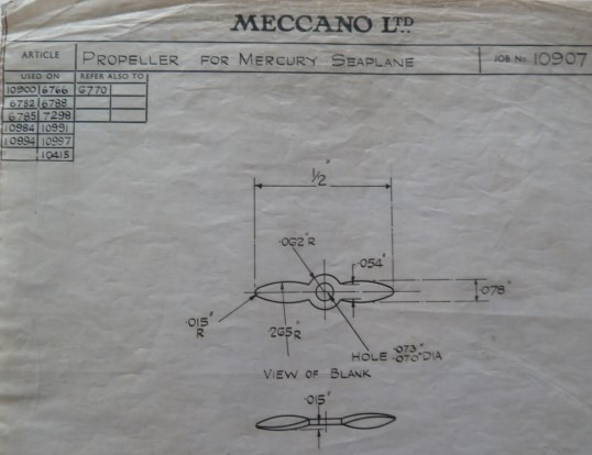

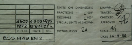

john45
Hallo Jake,Many thanks for your reply, it is always nice when collectors are interested in Dinky airplanes. I must admit that a two blade prop on the Albatross would show much better as a three blade. Why Meccano choosed not to use it is the question.
In 1938 the drawing was redrawn on linen with name Mercury flying boat. In the list you can see that the prop is used for total 12 planes. The numbers are the assembly drawings of all  the planes in production at that time. For info see the parts of the drawing I enclose.
Of course I know the Marshall book, from 1974. John Marshall for sure did not have the information we now have soo much years later. The many drawings with important information just came to light many years later, with thanks to Mike Richardson. Now we have much more info and can solve questions on Dinky toys. However with the efforts of all the writers from the past we never would have the knowledge we now have, so I am thankfull for every contribution on Dinky planes.
I enclose a few pictures of the original drawing.
John.
