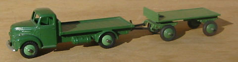

Hello all,
The reference 423 seem to apply to the Fordson Thames flat truck and trailer. I do not know the source for this reference and I can not find any information about it. (TMT, Vectis, QDT) Was it issued and is there a box to prove that it has not been made up like the one above on which one of the item has hubs in a wrong colour ?

I found this combination with salesnumber 30r/422 + 25g on Vectis with matching colours. Jan O.
Dear Jacques, I have one green fully matching combination of both, but they certainly are no couple, as they were bought separately, at different moments, moreover, one individually boxed. I have never heard of, or seen a 423 reference number for this combination. I have also checked my Meccano factory lists, where the number - if present at all - is left open, not filled in. Kind regards, Jan
