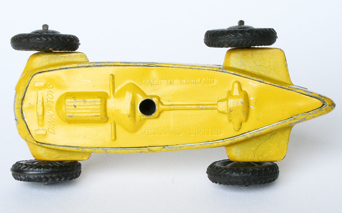

Here a picture of the second type baseplate.
John.
john45
Forgot that the Forum does not allow large high definition pictures.
Sorry for this. Now with the correct seize.
Second type pre war baseplate.
John.
john45
The two baseplates on the Mercedes Benz racing car.
Note that the second type is rounded at the end. The body has altered to provide the baseplate bending inside. Still no name stamped.
Top is first baseplate.
John

Walter,
Of course you are right, slip of the pen!
Here the two type baseplates of the Speed of the Wind.
John.

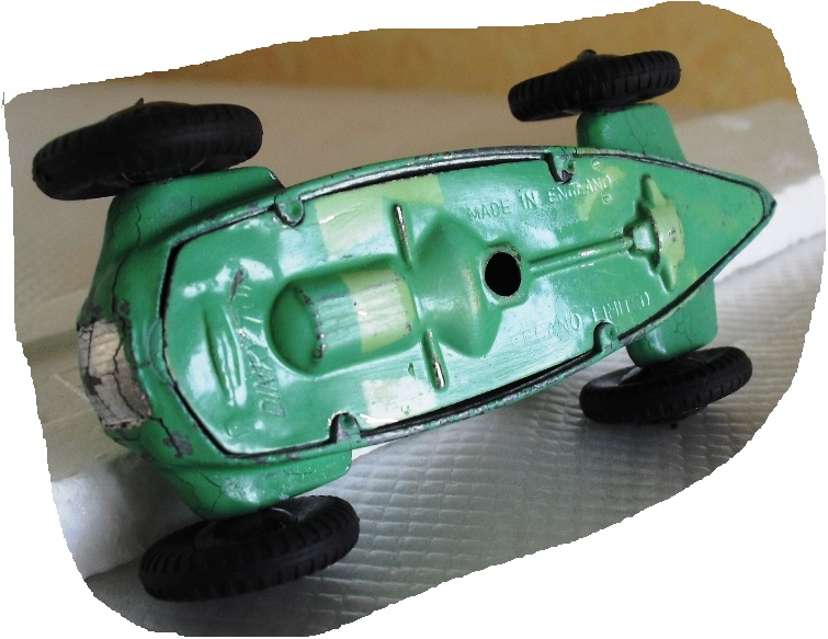

To complete this topic 2 photos of my "new arrival"
The inscriptions on the base plate are to read from the front to the rear.
I don't explain the sand color traces !!?? Sun, acid ?
Cheers
The discolouration could have been caused by a chemical reaction by something on which the model has rested over a long period of time as shown by the sharp edge at the front. Just a possibility as I have seen something similar happen to a late 1950s Dinky Toy.
However that does not detract from your Mercedes being a beautiful example! Top marks to you.

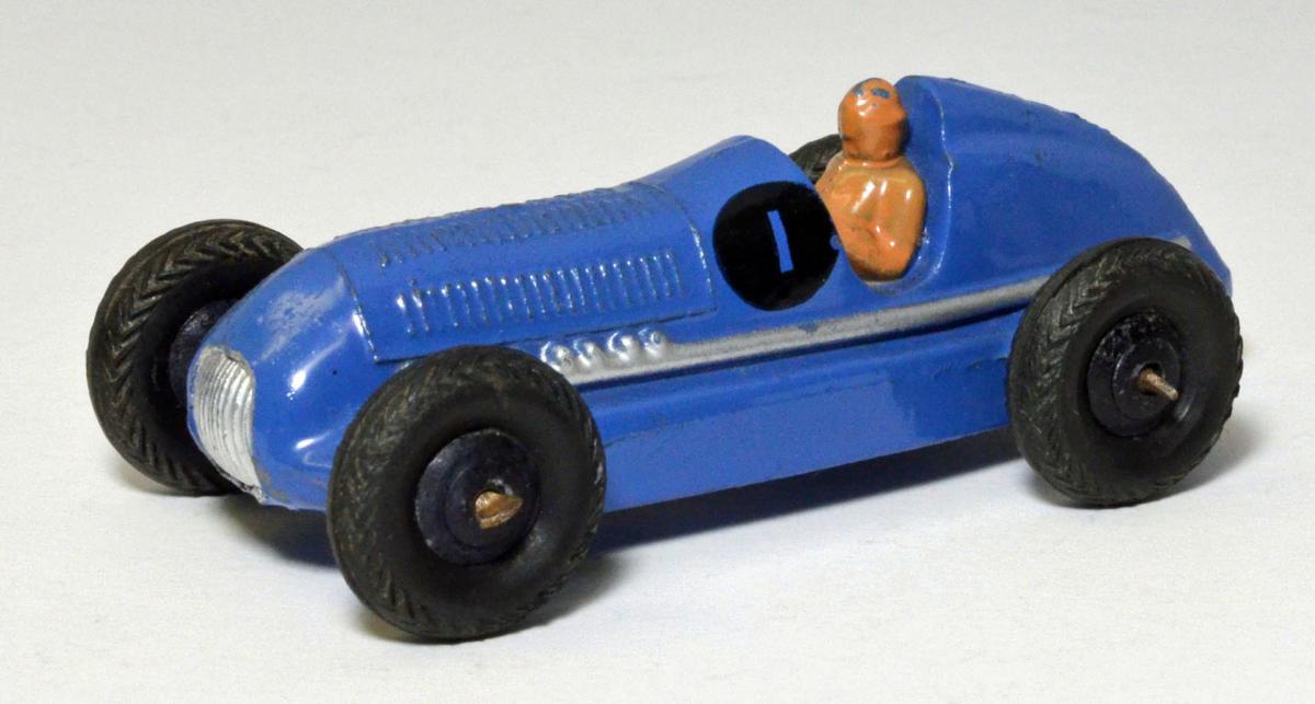

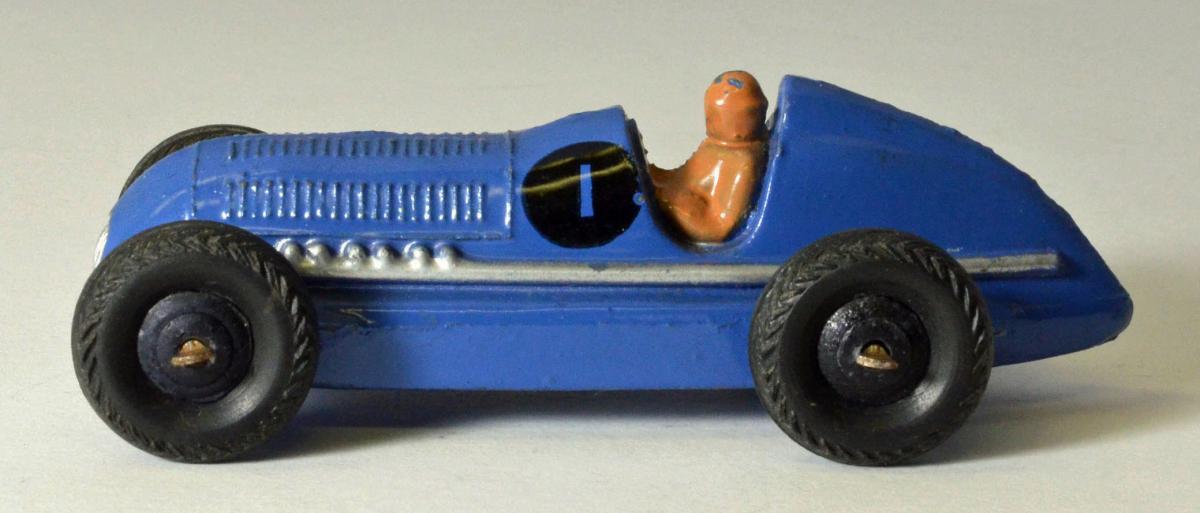

Have not seen any closeup  photos of the blue version of the Mercedes Racing Car, so decided to post mine.  I bought this several years ago from Keith Harvey, and it appears to be a somewhat later post war issue as it has the ridged wheels.  Of course more correct in the silver color, but the blue does show nicely.
              Best regards,  Terry

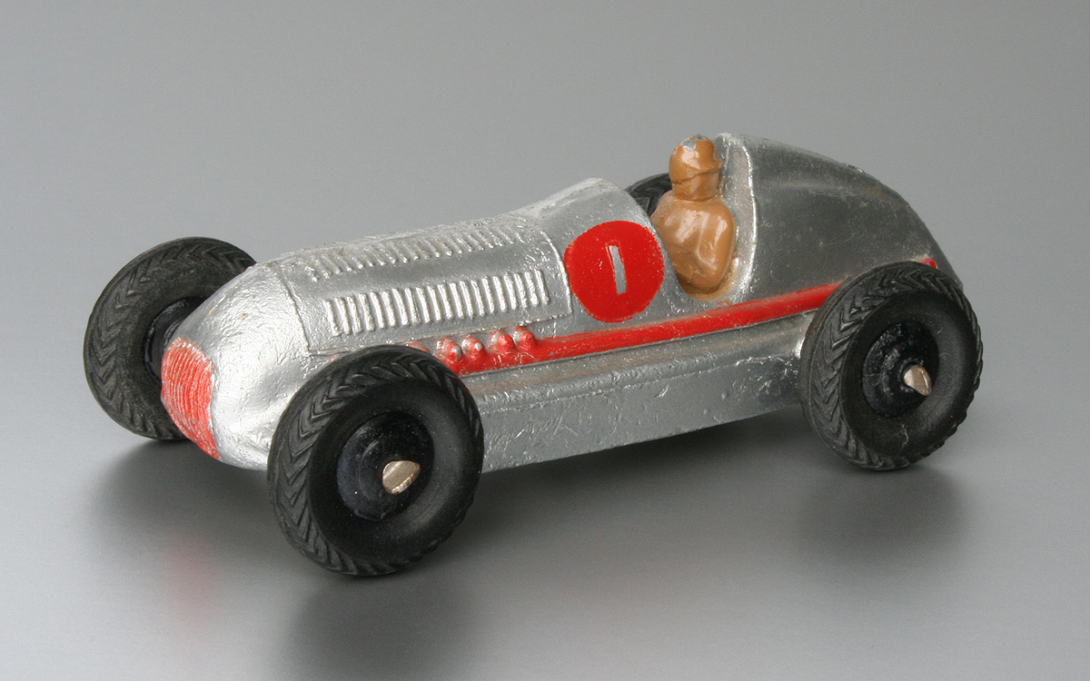

23c Mercedes Benz Racing Car, made from lead alloy
Lucky enough and against a rather large dent in my purse I was recently able to acquire this prewar 23c Mercedes Benz Racing Car. It is from the series with the 4 fixation points to help securing the clipped-in base plate. And: it is made from lead alloy, bringing 105 gr. to the scale instead of the average 70 gr. of a zink-alloy model!
The seller claims that "with this model the new fixation points for the base plate were probably tried. The use of lead thus probably contaminated the molds, which later led to the problems with metal fatigue in the use of zinc alloy. Therefore the versions with the fixation points are particularly affected today"
I wonder what comments I will receive on this!
And I miss Jacques, since he does not seem to be in a position to help.
Best regards from Thailand
Walter
Walter---A stunning, beautiful pre-war model! It is always a treat to see any pre-war Dinky in such nice condition, with none of the pesky fatigue. What year do you think this was made? It would be interesting to more thoroughly know just when and where Meccano used lead.
Bungo's picture
Bungo
23c was announced in Meccano Magazin in May 1936 (no Racing numbers, clipped-in base plate, no fixation points). Soon, Racing numbers were applied, then, the 4 fixation points came.
The details of my model (racing numbers, fixation points) suggest a production date of late 1936/1937, I believe.
Regards
Walter

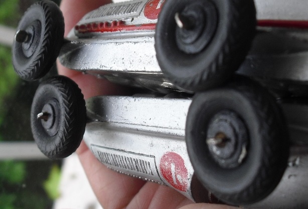

I received yesterday these two Mercedes 23c models.
I was very angry against me because I bought two identical models in the precipitancy !!! There were on sale on two different sites, almost at the same time and I absolutely wanted one !! So I did bid on both and ...... I got it , .... both !!! Stupid angry
BUT..... if you compare the models, you will see two differences smiley :
The race number "I" on one of the car is thinner than the other and the drivers colours are different : one is "caramel" and the other is in a lustreless brown colour !
So, I am happy laugh
Friendly yours.

Hi Richard,
Congratulations.
Unfortunately, the pics are not too clear.
Ridged or smooth hubs?
Thin or thick axles?
Best regards
Walter
Hi Walter.
Ridged hubs and thin axles.
Best rgds
Bungo's picture
Bungo
Hi Richard,
Now this is strange!
Ridged hubs were always mounted on thick axles, both being postwar items. There were early postwar models with thick axles and smooth left-over prewar hubs, but I have never seen ridged postwar hubs on thin prewar axles.
I know it's difficult, but can you try to measure them?
Thin 1.6mm
Thick 2.0mm
Regards
Walter
Hi Walter.
Yes, it's difficult to measure the axels.
In fact, I think that they are thick because it's look like they measure 2mm
I join two photos.
Friendly yours

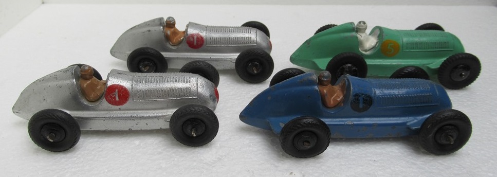

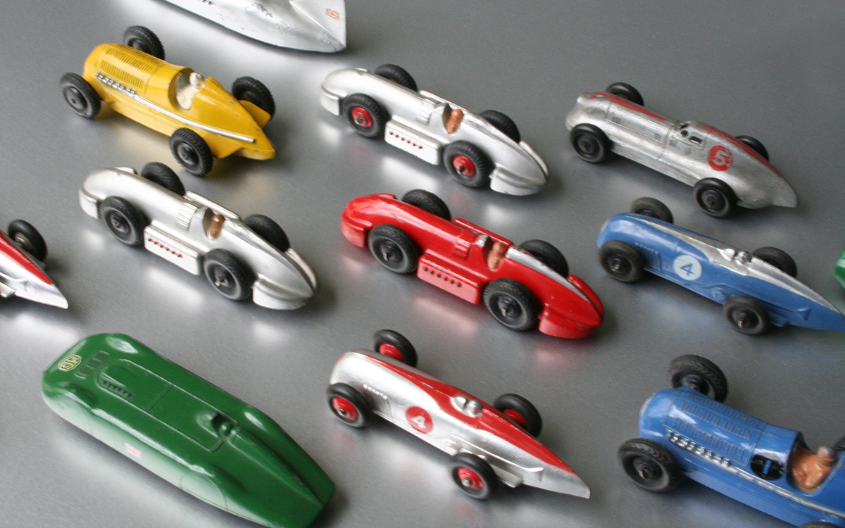

Here is a family photo with english and french Mercedes.
The french models are foreground.
A picture of the real one demonstrates that the wheels (+ tyres) of the 'regular' one are slightly too big and the metal wheels of the 1949 French version are far too small. Nice family, Richard! Kind regards Jan
The english Mercedes team is growing .... slowly but surely !
Hi Richard, good to see your expanding Mercedes group! What is the difference of the two silver examples? My silver post-war examples below, showing black (early) and red (later, export?) hubs. Two funny group portraits as a bonus, also featuring my blue and pre-war yellow Mercedes versions. Kind regards, Jan
