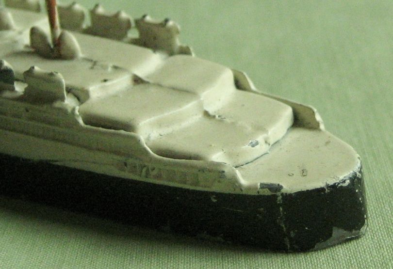

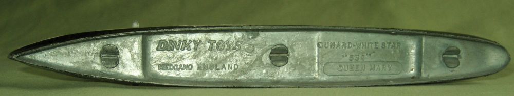

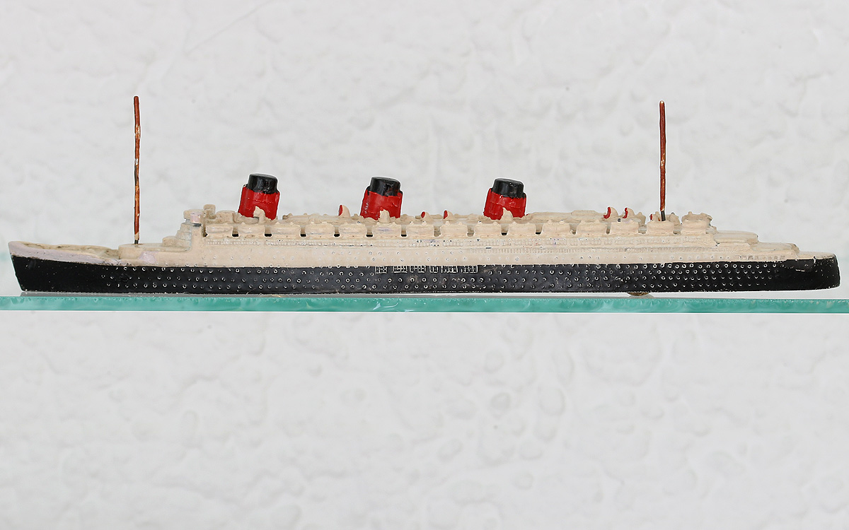

Now I have a new case. Except for well-known variations as boxes, numbers, text cast underneath, and with or without rollers, I know of no other differences in the casting of this model. Soon after I took my two models of the Queen Mary out of my displays, however, I discovered that my examples show a difference at the stern, i.c. the early '534/Queen Mary' shows a ridge there, representing the railing, whereas this seems to have vanished on my later 'Queen Mary' version. Now I wonder if this is an incident, perhaps caused by finishing the model under different conditions, or is this perhaps really a structural casting adaption? The only way to know is that others inspect their Queen Mary models and see if their findings are the same.
Two pictures in order to demonstrate. I hope they show the difference sufficiently:

Thanks for this new variety.
As you know I have a small collection of Queen Mary models with boxes. I checked the seven I have and indeed found one with a smooth deck.
Meccano made some different insides of the hull at the first models. No rollers, rollers on axles, rollers in tinplate frame.
So I looked at the inside and found that my model is with rollers and the tinplate frame.
Meccano had to change the die not only for the different text inside, but also to fill the holes in the hull after changing to a tinplate frame for the rollers.
So my model has filled in axle holes, still visible, and a injection mark at the front.
My conclusion is that there was a major change at the tools for the die.
For those who want more information on the Queen Mary and the different boxes, see The Journal 2012 July with a article on this subject.
John.

This is my Queen Mary which has no rail around the stern. I do not have a box but the second photo shows the underneath.

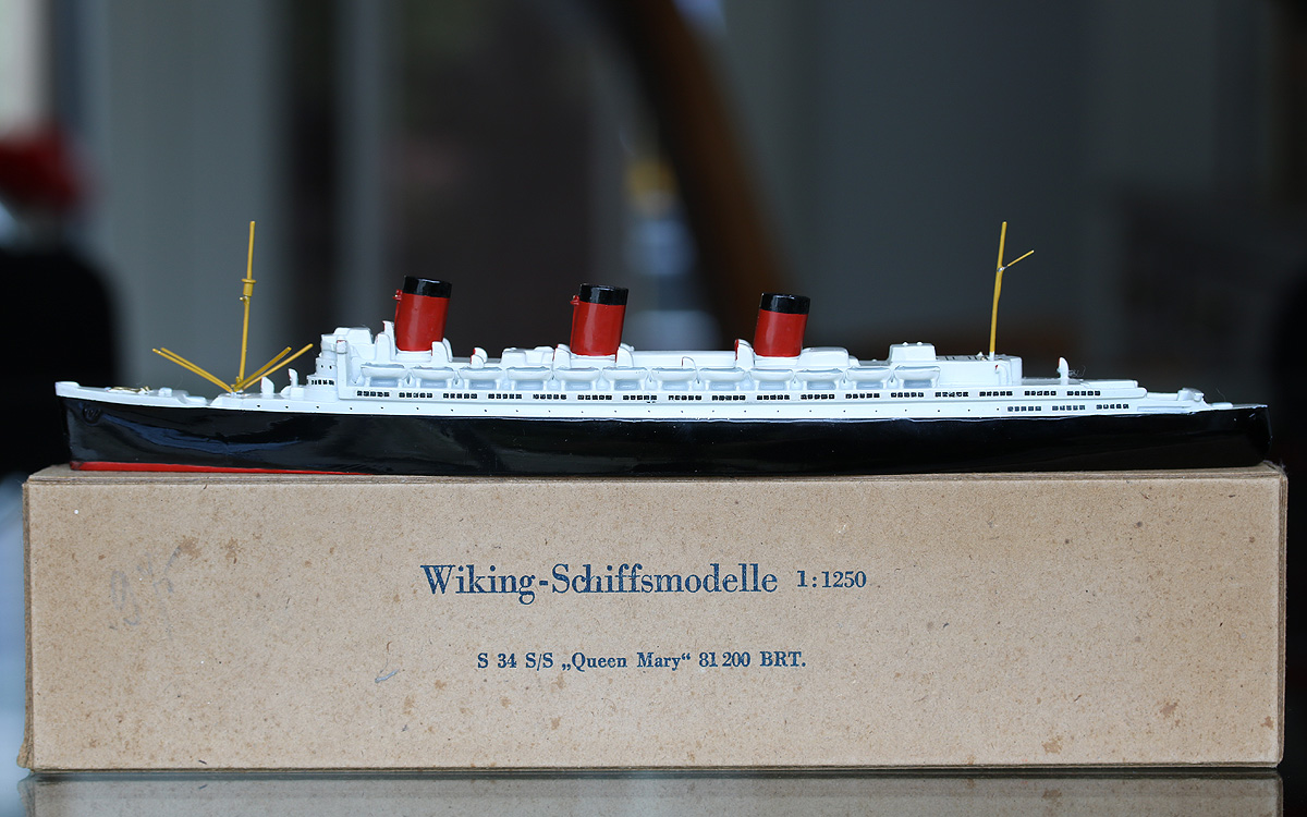

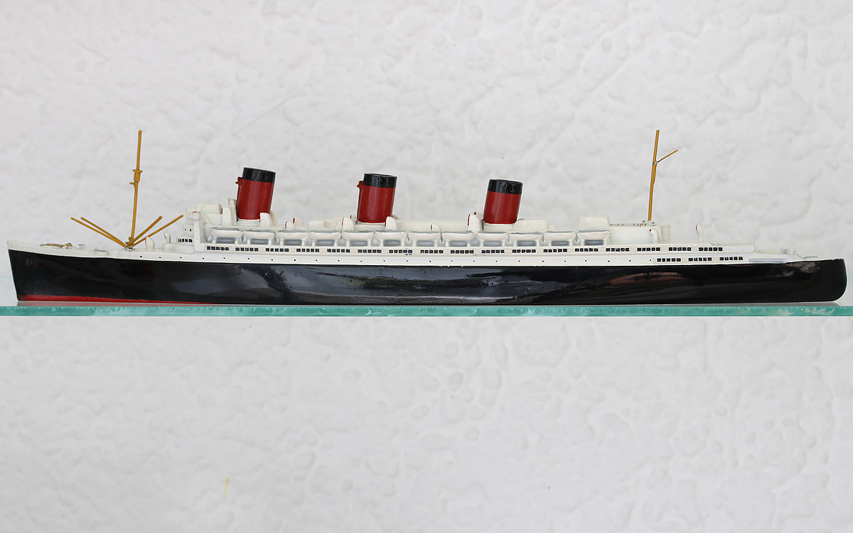

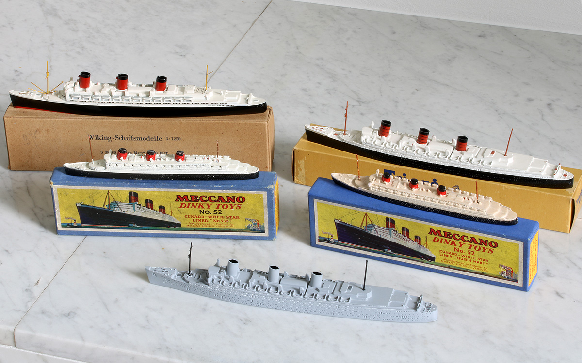

The acquisition - yesterday, from a collector friend, at a very symbolic price - of a magnificent Wiking no. H413 Queen Mary - invites for a comparison with the Dinky Toy and the Tri-ang rendition. The model is cast in lead with some additional zinc. The mould is pre-war (1938) and I presume this post-war re-issue dates from the period 1948-1956. It needed some good cleaning and a bright, as new model showed up. Some comparisons in figures:
Dinky 175mm, scale 1/1800, weight 94g (zamac)
Tri-ang 259mm, scale 1/1200, weight 175g (zamac)
Wiking 249mm, scale 1/1250, weight 455g (lead)
I would say, make your own comparisons and draw your own conclusions! Kind regards, Jan
