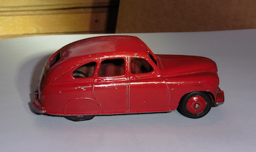

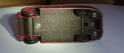

Hi DTCA, This is my first ever posting so I hope I do it correctly. Joan here at Toys in Time. recently we had a visitor to our museum. He asked me to help him find out about his Dinky Vanguard. The first place I looked was the DTCA website, and here is discovered a lot of helpful information for him. It appears that he has maroon Type 2 Vanguard with closed spats. The box apprears contemporary but has no markings. I enclose (Ihope if I get it right) some photos of the car. He is interested in selling it so I wonder if any DTCA members might be interested in buying it. If so can someone please let me know the correct way to offer that to DTCA members. Many thanks for your help and interest. Kind regards, Joan Nessl
