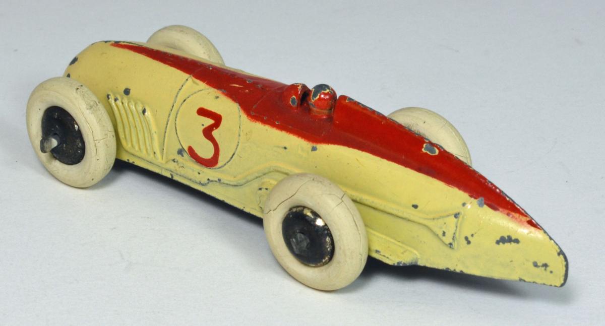

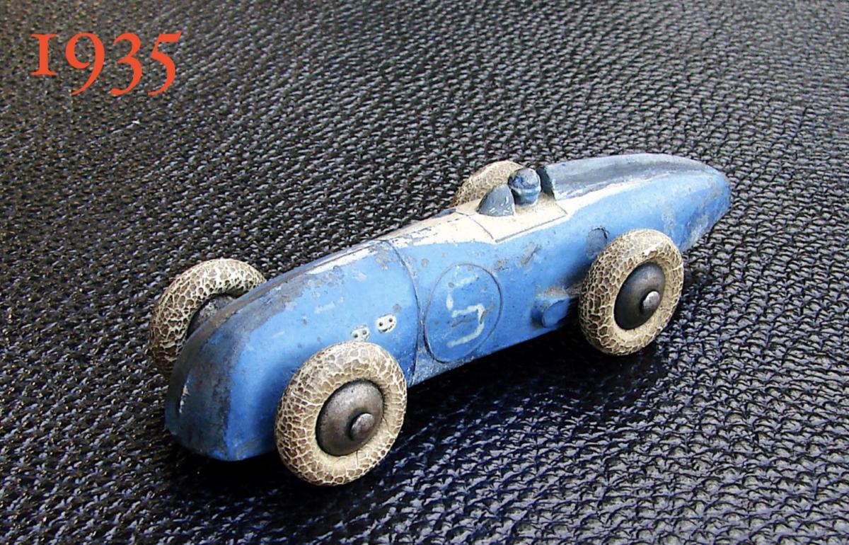

And what about these?
Hi Walter, thank you for your comment! I agree, I was aware of these cases, especially for the  the 23/23a. Perhaps we should make a difference between 'incidental' and 'structural' occurences of the domed axle ends. That's why I carefully limited my remarks to introductions of new models (and continued subsequently). Kind regards, Jan
Bungo's picture
Bungo
Thing is, Jan, that when the 23 Racing Car came out in early 34, it had this domed axle end on one side, crimped on the other. Structural or incidental?
Why did Meccano make our lives so difficult, after all these years?wink

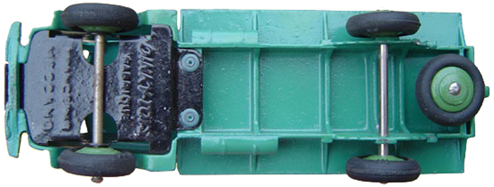

                                                     Underside of an early Triumph 1800 with diecast posts for the rear axle
                                                     Thank you to the nice guys at QDT who provide photos of the underside
                                                     for most of the models they sale.
In july 1948 the B.E.V. electric truck and the early Triumph with diecast posts for the rear axle have pre-assembled axles.
