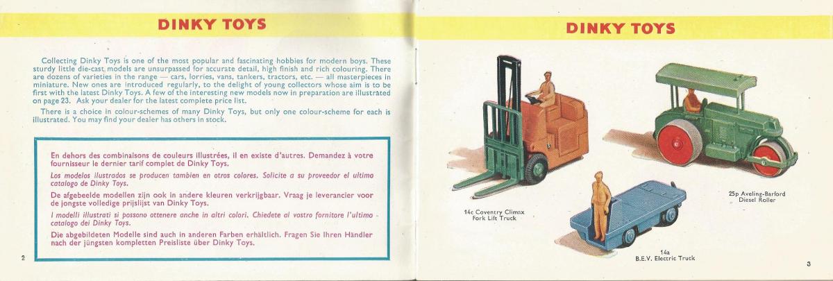

I'm working on an article about the beginning of the Dinky Toys catalogues UK after the war. Does anyone know anything about the existence of Dinky Toys catalogue UK 1952 ref.no. 16/152/50 (February) 16 pages and 16/452/50 (April) 16 pages. These are as the first UK catalogues mentioned in the 15th Ramsay's model toys catalogue, but I've them never seen anywhere. I myself have those of Sept. 1952 Ref.no. 15/852/165 16 pages and the 1952 International colour catalogue ref.no. 13/552/130 24 pages. I am a new member, for the first time in this forum and hope that the pictures of my catalogues are added.

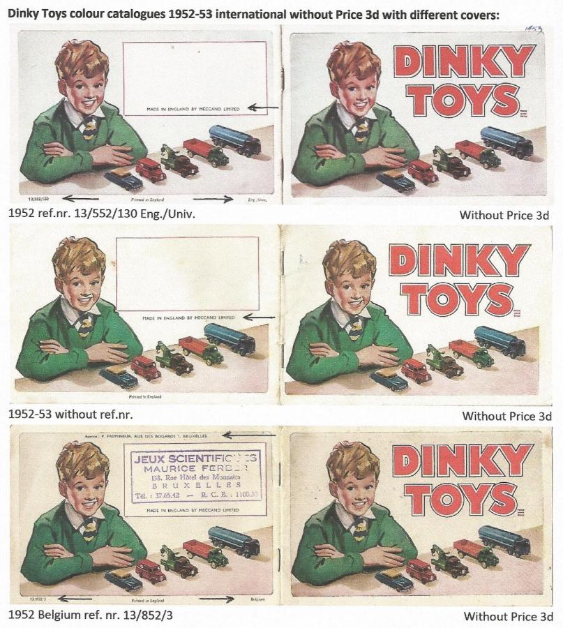

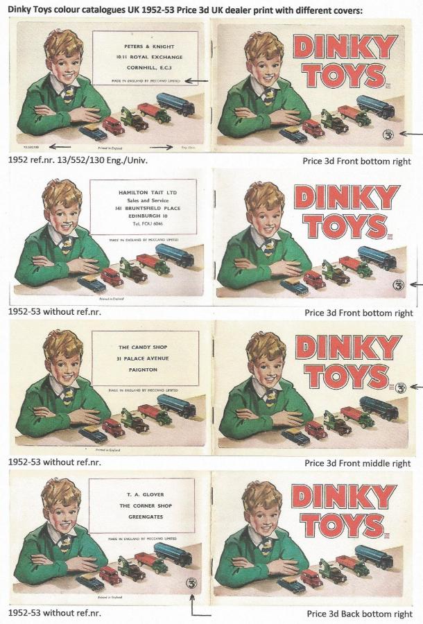

My earliest UK catalogue  is 13/1050/80 12 pages. I also have those catalogues you have listed in addition I have a UK version that is identical to 13/552/130 except the 3d price is on the back cover and page 23 shows models that were introduced after November 1952, so this catalogue would have had a print date of 1252 or even 153. This could be the catalogue in Ramsay shown as "1953?".

Just received Dinky Toys color catalogue Canada 1952 ref.no. 13/852/25 with a Canadian shop stamp.
Now I have eight different covers of the 1952 international color catalogue. 4 UK and 4 International.

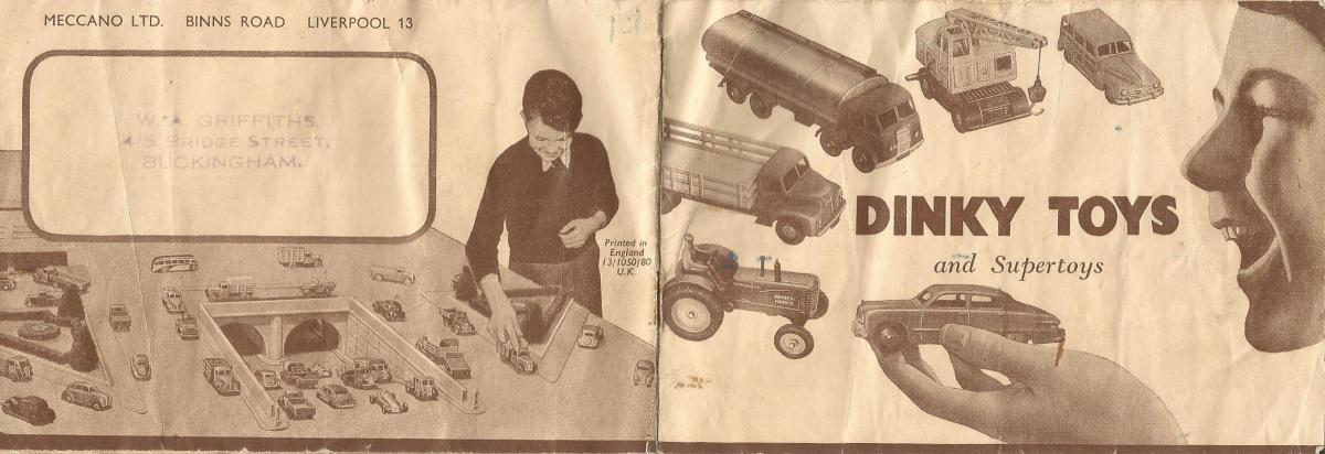

In reply to Bruce: I have also the 1950 UK catalogue. Remarkable that Ramsay starts with UK DT catalogues in 1952 (1952-1978), while the first full UK DT catalogue after the war was published in 1950. All countries started with a continuous serie of catalogues in 1950, even France in 1949. Only for UK there is a gap in 1951, because no full UK catalogue was published in 1951. I possess one UK DT 1951 illustrated leaflet ref.no. 16/551/15 and three UK 1951 illustrated General Meccano fold out leaflets with Dinky Toys, ref.nrs. 16/251/33; 16/651/75 and 16/1051/25, all with 8 pages. I can add pictures now and can add information to the pictures so the comments can be made complete now. Congratulations for the new website of DTCA and good work from the webmaster and all the people working on the construction of the website.

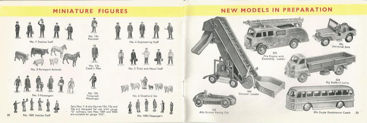

I have also an UK 1952 international colour catalogue Price 3d without ref.no, with an UK dealer print. There are differences in "The new models in preparation" on page 23 of both catalogues. According to the Dinky Toy compendium of Patrick Trench in volume 4 of the Hornby Companion Series are The new models in preparation of those with ref.no. 13/552/130 issued in 1952 (so it is a 1952 catalogue), while those without ref.no. were issued in 1953, so the last catalogue perhaps may be published after the Sept 1952 catalogue and may be just dated 1953? That's the question and the problem of no print code. All catalogues have a print code but just this one has not. Maybe that's why a question mark is behind the 1953 no ref. catalogue in the Ramsay. Remarkable in this case is that from the international catalogue without ref.nr. only model 23f, 25y and 29h of the "recent additions to the range of Dinky Toys" on page 22 are found in the UK Sept. 1952 catalogue and of all the "new models in preparation" on page 23 of the same catalogue even none model. This indicates that this catalogue  must have been published after the Sept 1952 catalogue and in line of the reply of Bruce, perhaps 1252 or even 153. Production  of "new models" went obvious not so fast before publishing new models in the Sept. 1952 catalogue.  In the meantime of construction of the website I discovered a mistake in the list of UK catalogues in the Ramsay that solves my question in the begining. The first two 1952 UK DT catalogues in the Ramsay, mentioned in the beginning of this topic, were placed in the wrong list. These are general Meccano products catalogues and belongs in the list of Meccano catalogues of the Ramsay. I discovered the error because, besides the DT catalogues, I have almost all general UK Meccano catalogues and went to compare the DT list of Ramsay with the Meccano list of Ramsay. Remarkable is that also the colour catalogue 1952 Price 3d ref. 13/552/130 is not mentioned in the Ramsay.  It was the first colour catalogue after the war and international in total 6 languages with no prices and the note: "Ask your dealer for the latest complete price list", so it is a very special catalogue for much countries. I possess one international catalogue for the Belgium market with the print code 13/852/3 (only 3000 copies!!) with exactly the same content as the UK catalogue with ref.nr. 13/552/130 Price 3d. Perhaps there are more country specific copies of these 1952 international colour catalogue? I possess 7 international colour catalogues 1952 with different covers, 4 UK 1952 Price 3d with UK dealer print and 3 international  1952 without Price 3d, all with identical content. I'll send a message about all this to the editor of the Ramsay. I am a contact person for the Ramsay catalogue before additions of the Dutch DT section, but send also additions/informations about UK, USA and French DT catalogues.
