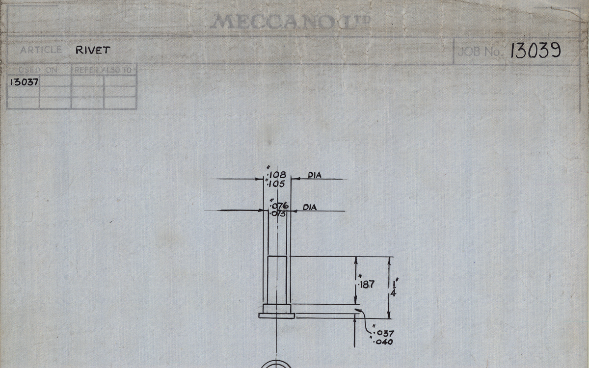

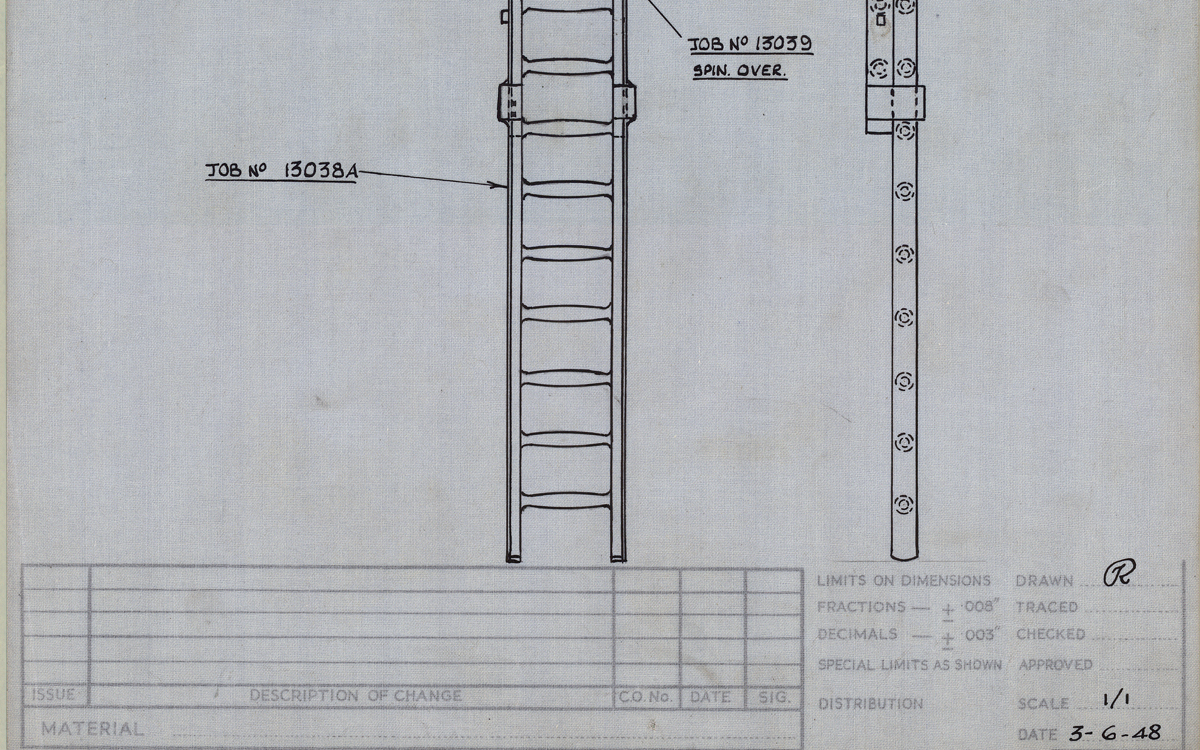

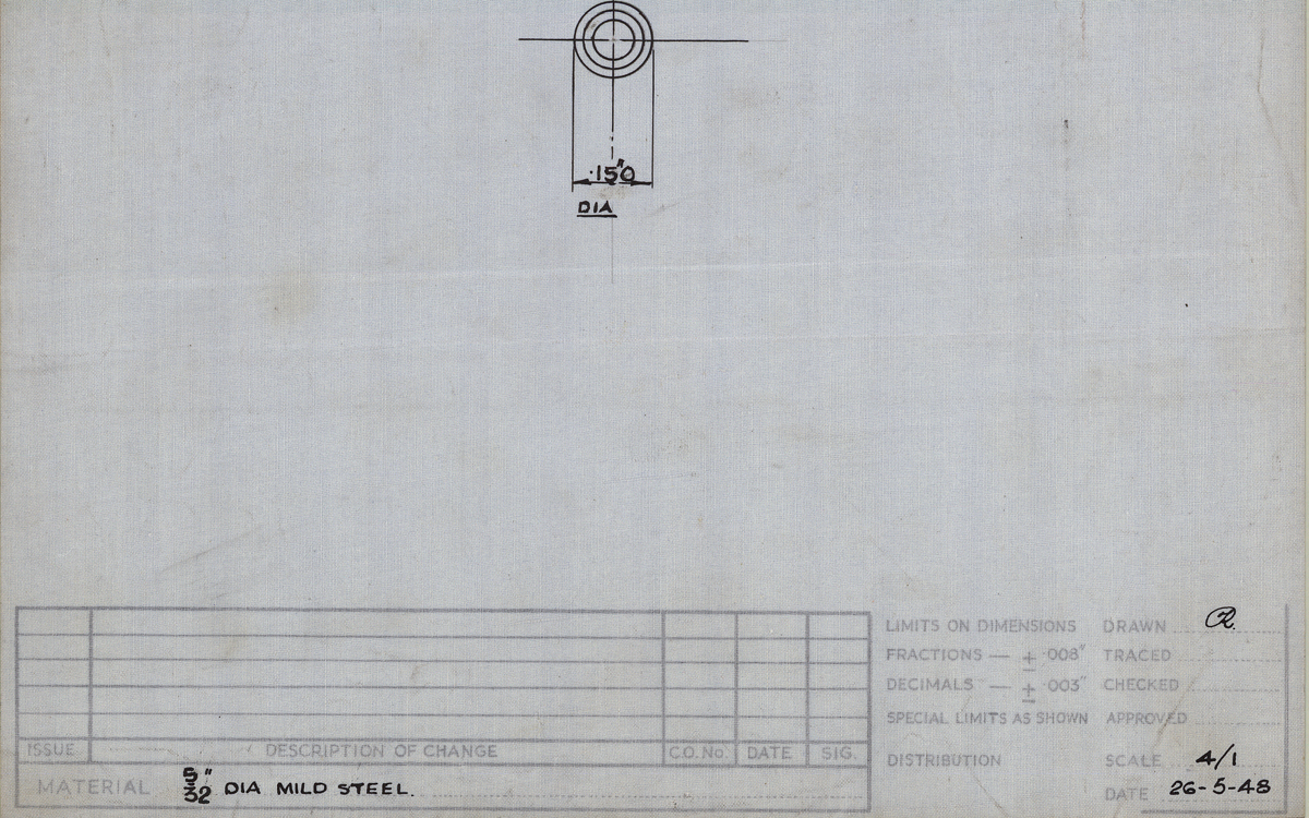

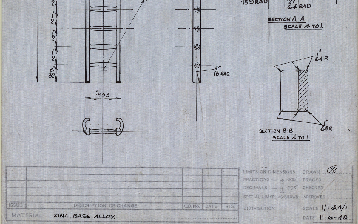

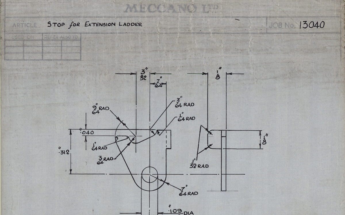

Evidence of its planning is found in:
1. The existence of 4 design drawings of May and June 1948 (ill. in DT&MM page 256, ref. in GBof DT page 212).
2. The existence of a mock-up (Christie's South Kensington catalogue 26-27 September, lot no. 793).
3. Reference in the abovementioned Dinky Toy Job List Index.
