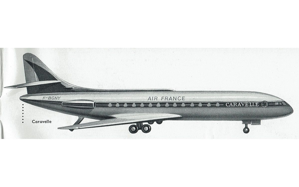

Two remarkable catalogue misrepresentations of the Caravelle below:
1. The introduction as a 'nouveauté' in the French 1958 Meccano catalogue, showing a straight blue band, even extended over the cockpit area and even over the engines sides. The blue tail flash is very plump compared with the actual model. The AIR FRANCE capitals are too large as is the odd CARAVELLE name at the front of the blue band. The main landing gear seems to be represented showing tyres.
2. The Dutch (and other similar) 1959 Dinky Toys catalogues show a fully distorted Caravelle model. Possibly lacking an appropriate example or just being in a hurry to finish the job the artist apparently 'borrowed' the main fuselage and wing details of the Super Constellation, the registration numbers included. A fantasy cockpit and a crude, plump tail section were added to complete the design.
Jan—-Just when you think you’ve seen everything....right? That is downright amazing!
