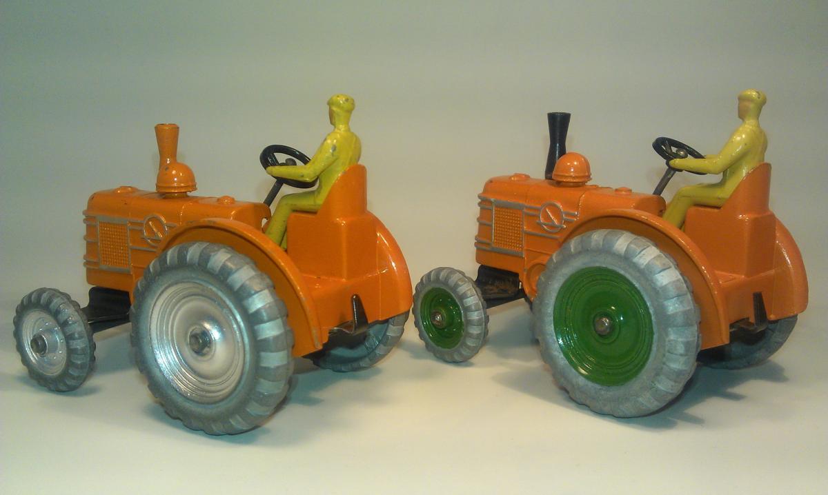

The Field Marshall was always issued in orange colour en had 3 versions:
  1. metal wheels, silver hubs, orange exhaust and tan cast driver.
  2. metal wheels, green hubs, black exhaust and tan cast driver.

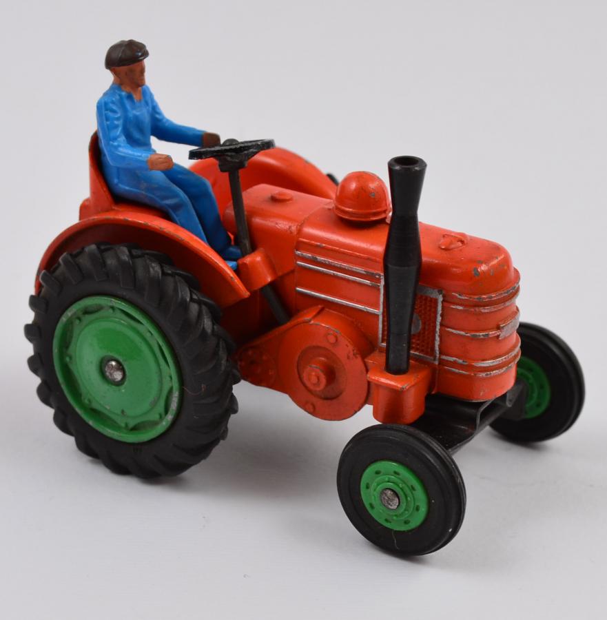

  3. black rubber tyres, green plastic hubs, black exhaust and blue plastic driver.
My Field-Marshall tractor 1st version.

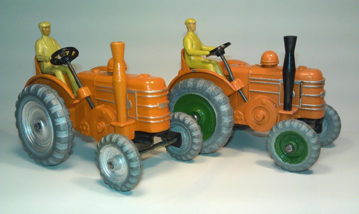

My 2 main versions Field-Marshall tractor: left 1st version – right 2nd version.
2 main versions Field-Marshall tractor.

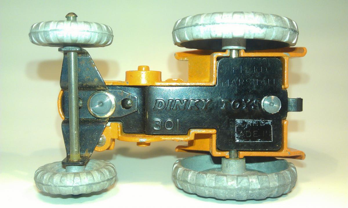

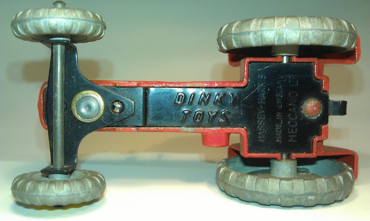

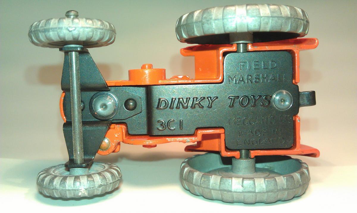

Base plate Field-Marshall with sales number 301. Partly engraved and partly embossed. Note the not fully embossed 0 in the number.
Dinky Toys Field-Marshall 2nd version base plate with fully embossed number 301.

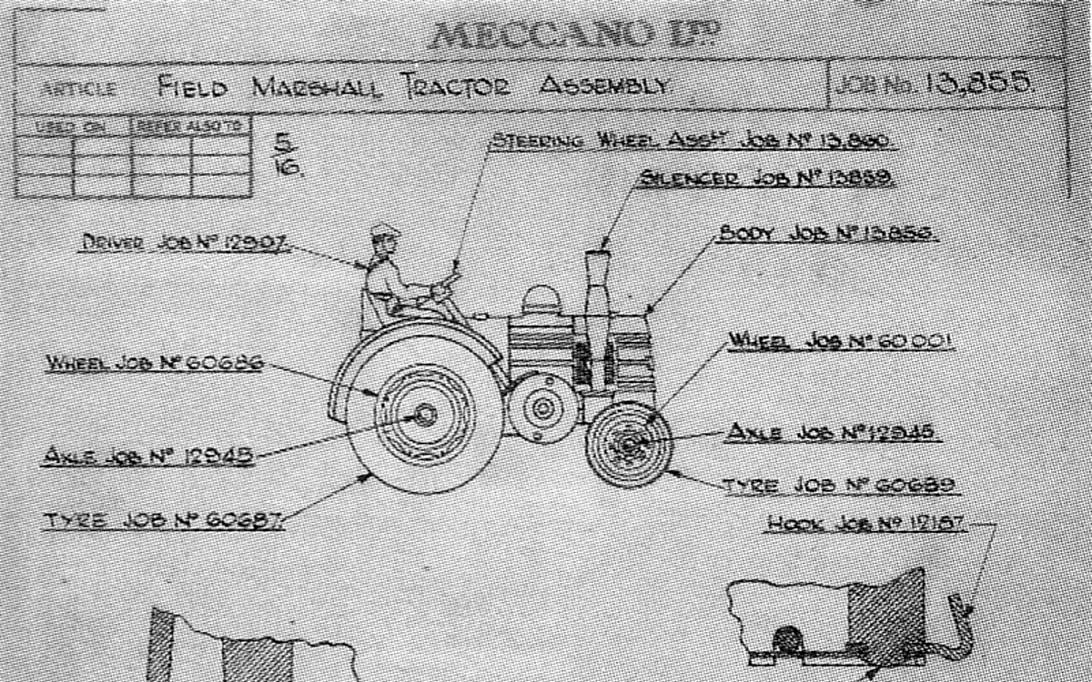

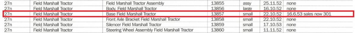

Details drawing Field-Marshall tractor Job no. 13857 in GBDT that stated: 16.6.53 sales now 301.

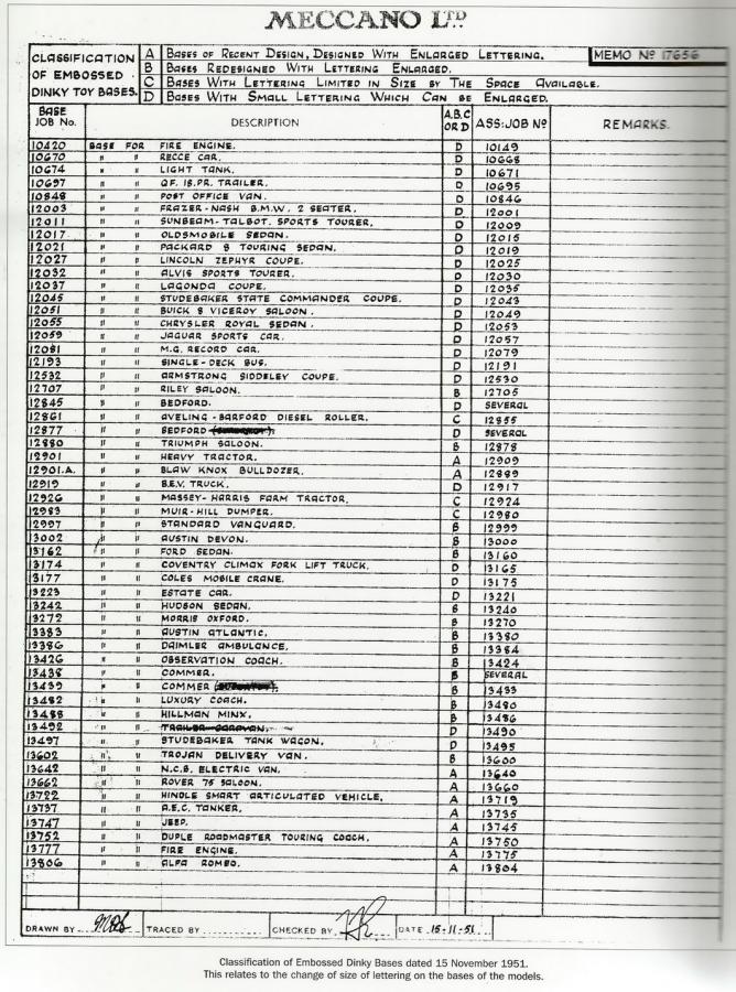

Classification list of embossed Dinky Toys bases p 218 GBDT.
It’s interesting to know that there perhaps might have been something special with the base plate of the Field-Marshall tractor considering the above classification list of embossed Dinky Toy bases dated 15-11-51, but the Field-Marshall was issued after that date.
The Massey-Harris farm tractor is classified C which means: Bases with lettering limited in size by the space available. That’s why the base of the Massey-Harris could not get a sales number because of too little space for it. The base of the Massey-Harris has front 9 mm and back 23 mm, but the base of the Field-Marshall has front 14 mm and 27 mm on the back as space for the number. So, the Field-Marshall had, as shown below, enough space for the number 301 in the base.
Outside that is the base plate very peculiar as it is partly engraved and partly embossed. This means that the base plate is also printed twice (separately?) That is also the case with the Massey-Harris tractor and I know examples of the Bedford Articulated Lorry which I own. May be Jacques Dujardin can explain that.
Base plate Massey-Harris tractor without sales number. Base 9 mm front and 23 mm back.
Base plate Field-Marshall tractor with sales number 301. Base 14 mm front and 27 mm back.

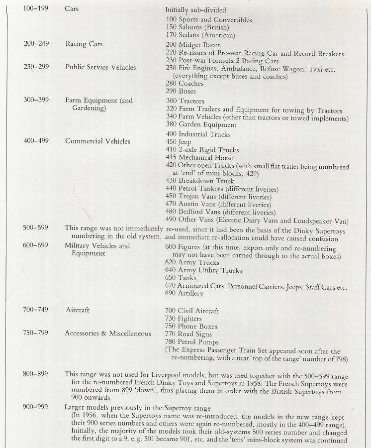

To solve problems with the old numerical + alphabetical numbering system of Dinky Toys sales numbering, they decided, somewhere in the early 50's, to start a process of renumbering according a classification list below with a new system of numbering.
The new numbering did away with alphabet characters completely, and was based on the allocation of blocks of 50 or 100 numbers to the different types of models, and in some cases mini-blocks of 10 or 20 numbers within a main block to further sub-divide the type of model. (DT & MM).
Classification list with the renumbering system p 296 Dinky Toys & Modelled Miniatures.
But when did the renumbering actually start in practice and when did it ended? I try to show it in chronological order.

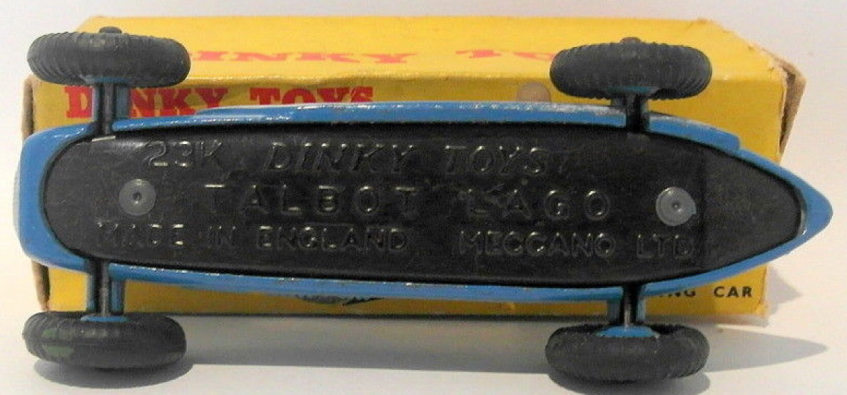

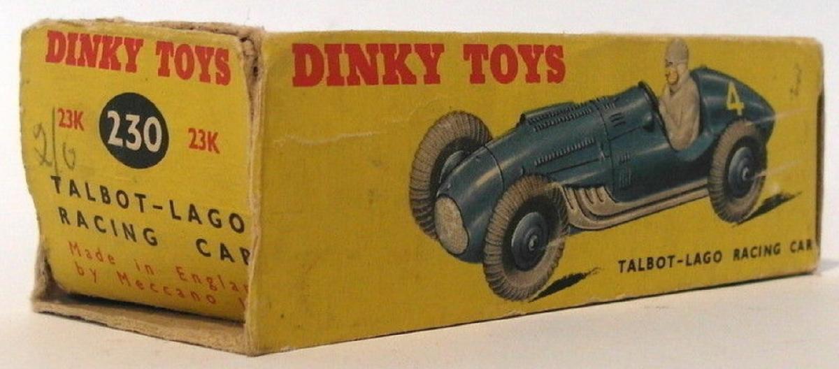

1) the 23k Talbot-Lago racing car in September 1953 was the last issue produced with the old numerical + alphabetical number 23k and base plate 23k
Introduction 23k Talbot-Lago racing car in MM September 1953. Last issue of the old numbering system.
23k Talbot-Lago racing car introduced in September 1953. Last issue with old number in the base plate. Photo Ebay.
23k Talbot-Lago racing car. Last issue of the old numbering system that also got a dual numbered box. Photo Ebay.

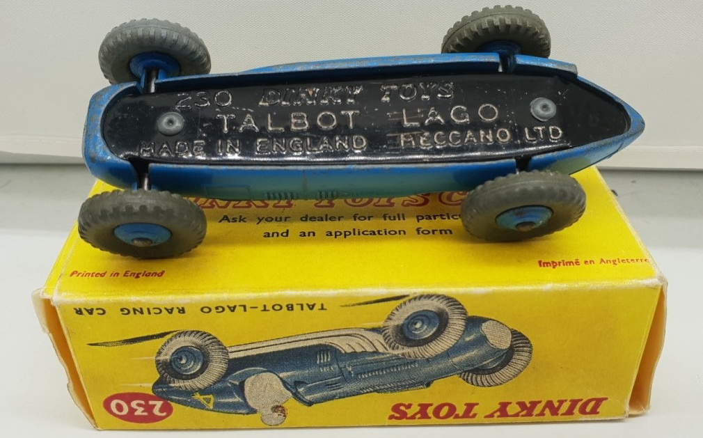

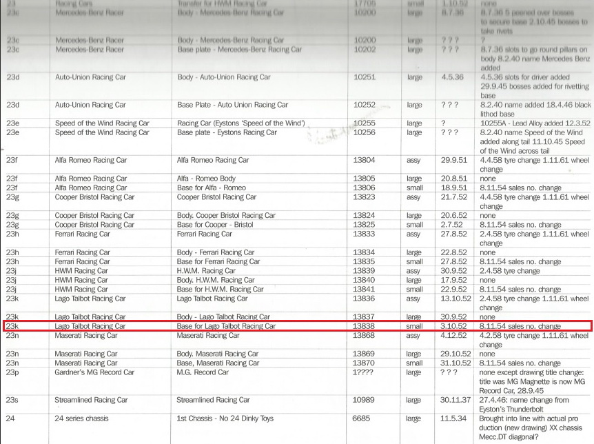

As to see on drawing list p 174 GBDT above, the 23k and all post-war 23 series racing cars were 8.11.54 renumbered.
Renumber 230 in base plate and box Talbot-Lago racing car on 8-11-54 according drawing list. Photo Ebay.
 2) the Field-Marshall was the first issue that received a new number 301 on the base instead of the intended 27N as announced in MM October 1953. In fact the Field-Marshall was the 1st issue of the renumbering which also got a dual numbered box 301-27n.
Drawing detail base Field-Marshall tractor: 16.6.53 sales now 301.

So, I may assume that the renumbering ended in 1956.

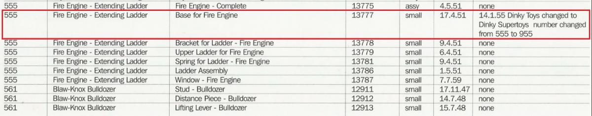

Note: What strikes is that the 555 Fire Engine was already announced in MM March 1954 with renumber 955, while the date of change on the drawing list of the base, first stated 14.1.55, when it also changed from Dinky Toys to Dinky Supertoys.
Drawing list 555 Fire Engine with details about the base.

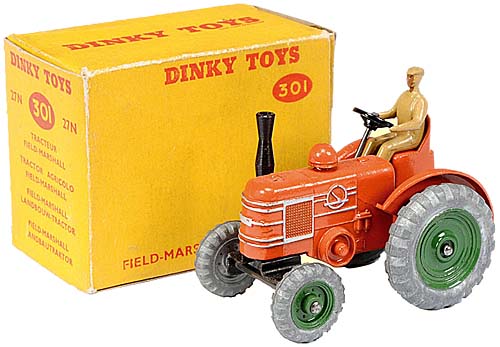

Dinky Toys 301 in Dinky Toys catalogue UK July 1954. Note that the green hubs have changed from silver to green after such a short time.

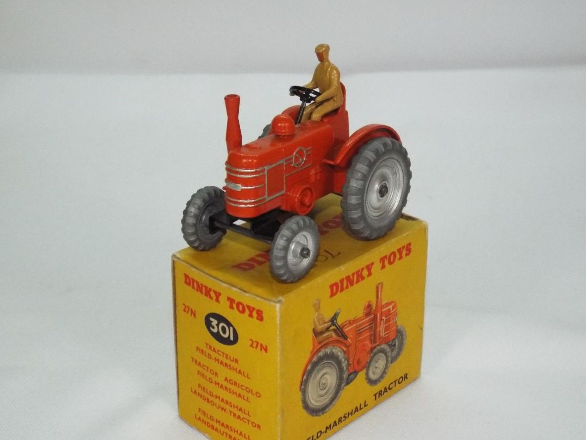

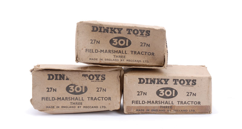

Dual numbered picture box Field-Marshall tractor. Photo Ebay.
Dual numbered dealers trade box of three Field-Marshall tractor. Photo Vectis.
In the transit period of the renumbering were for the Field-Marshall tractor a yellow dual numbered picture box and a grey/brown? dual numbered cardboard trade box of three issued with the numbers 301 and 27N. Regarding the picture of the trade box it looks like that the trade box contained 3 boxed tractors? I could not find any further information about this trade box.

On the image above in Dutch DT catalogue 1962 is the 301 shown with black rubber tyres, green plastic hubs, black exhaust and tan cast driver. This is the existing 3rd version, but I have never seen this model with a tan cast driver. It is a mistake in the image because this model is according the list on page 40 GBDT below, since 1962 issued with a blue plastic driver as pictured below. Vectis also shows this model only with a blue plastic driver. This error in the image remained in all catalogues till 1965.

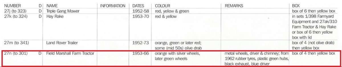

List with details 27n (301) p 40 GBDT.
3rd version Dinky Toys 301 with blue plastic driver. Photo the Saleroom.
Drawing Field-Marshall tractor in Ramsay 15th edition.
There is a small unreadable factory drawing of the Field-Marshall tractor printed in Ramsay 15th edition catalogue. It is a pity that it is apparently not in the hands of the DTCA and included in the PDF library for information to DTCA members.

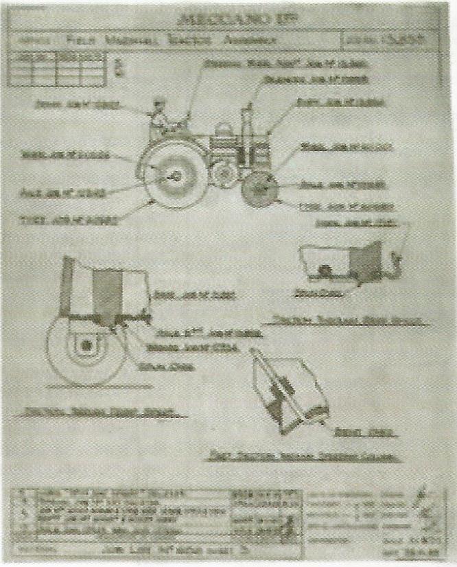

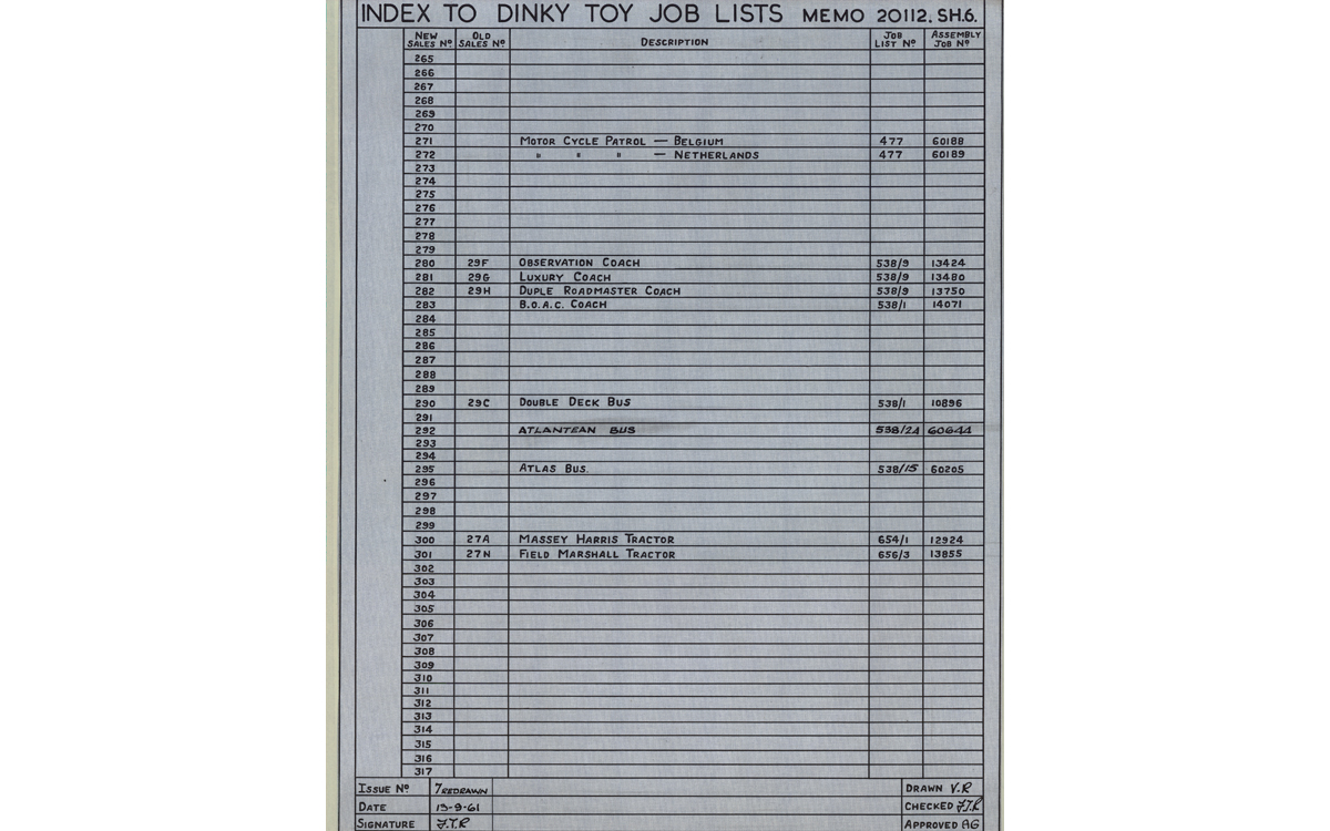

Perhaps the drawing pictures below will be of help to you, Jan. The first one demonstrates the long-time knock-on-effect of the renumbering operations in the mid-1950s. It is sheet 6 of a long 19 sheets Index to Dinky Toy Job Lists, redrawn on 13 September 1961 and still includes references to the old catalogue numbers which were discontinued many years before.
The second is a better picture of the assy shown by you and referred to in sheet 6 as job no. 13855. This drawing was included in the October 2000 auction catalogue by Christie's South Kensington of the Richardson Collection. I cut it into two pieces and manipulated the visibility a little bit in order to present optimal data information. They overlap slightly so you might even consider to re-stitch them. Kind regards, Jan
Jan, amazing. What a wonderful additional information. Very valuable if you can collect this kind of information through auction catalogues. I do not follow auctions like that, but it does produce very valuable information. I focus more on DT catalogues.
I hoped for a readable drawing of the Field-Marshall and that has now been added by you. Many thanks for that.
I hoped to be able to see changes to the Driver Job No 12907 from cast to plastic driver. But I do not see that. I see mentioned Wheel Job No 60001 + 60686 and Tyre job No 60687 + 60689 (14-11 ?? - 61), not clearly readable, that probably refers to the change from metal wheels to plastic hubs and rubber tires. Axle Job 12945 was Job 12946 at 28 -8-5 ?? (date also difficult to read). If it was 28-8-53, it was before introduction in October 1953. I do not see directly difference in axles between my version 1 and 2. I must confess that I am a beginner in reading and explaining this kind of drawings.
The index to Dinky Toy Job Lists is also very special. Very valuable information. I count 53 consecutive numbers on sheet 6 x 19 sheets = a total of 1007 consecutive numbers which could filled in with a new model. Funny to see number 272 Motor Cycle Patrol - Netherlands is the ANWB Motor Cycle Patrol which was introduced in 1959 and deleted in 1962. All very valuable information and nice to have. It also shows that the process of renumbering was accurately administered. It is a pity that the list does not show the date of the renumbering per sales number. That would help me to more accurately reflect the renumbering process.
Do you know if Meccano Liverpool for the Dinky Toys also made separate Paint Job Lists for the colours that have to applied to the models? That would make it easier to determine existing colour variations or combinations in the models.

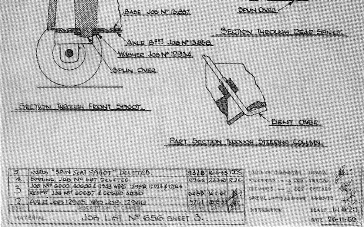

The drawing which is for the variation with tyres  mentions : "words "spin seat spigots" deleted" and date 16 06 65 certainly relates to the change from metal to platic driver. Job No 12907 is the plastic driver. I have not yet found the job N° for the metal driver.
60 001 is for front plastic hub
60 686 is for rear plastic hub
"Job 60 687 & 30 389 added" relates to the change of metal to rubber tyres. Sorry, I can not read the date, probably 14 2 61.

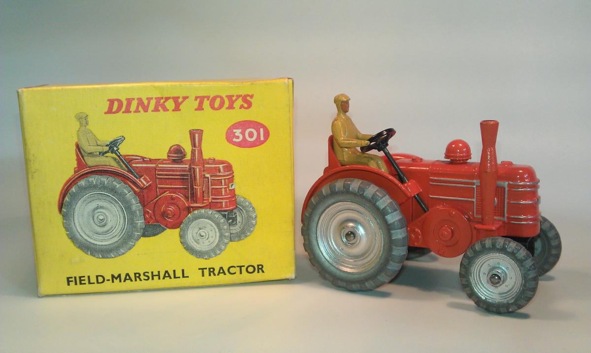

I have found on Vectis this rare early 301 yellow box which might help and complete your research.
The renumbering was probably done during only one or two days when the list of new numbers was added to the existing alpha numerical list. From that day the new boxes were printed when needed with the dual references over a period of perhaps a year. You will never find a list of the dates when new boxes have been printed and made available on the market.
