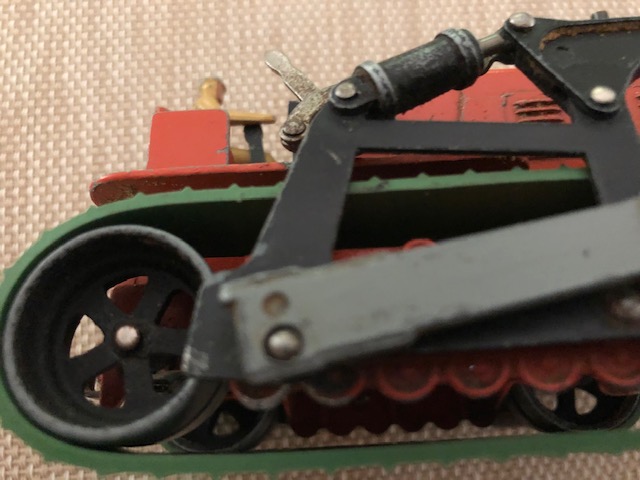

I finally found the way to replace the tracks with a minimum of "damage" to the bulldozer.
1.- I realized that the blade's pivot pin on the rear is headless and you can pry the arm very carefully outwards to free it from the pin.
2.-  Squeeze/grind the front upper link pinched end to be able to slide the link out of the black lever.
3.- Pass the tracks one after the other through these openings: (Note: work on one side is enough).
4.- Refit and  squeeze again the upper front link .

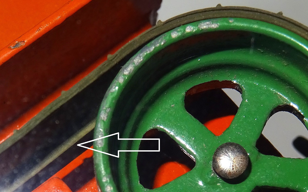

Wondering, though, if spare tracks available on the market are all "guiding ridge missing"? Did the originals had it?(I do not remember...)
I can see this 'guiding ridge' inside the (original) tracks of all examples of both the Bulldozers (British and French) and Tractors that I am able to inspect.
